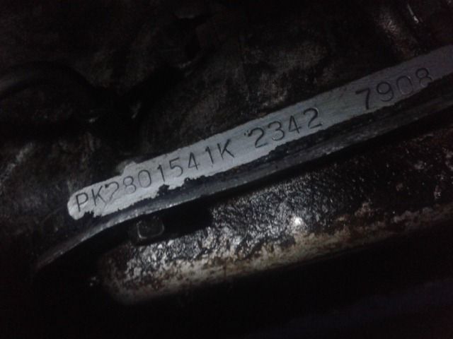

here is a picture of the numbers stamped by the sump pan
any info or links to a website much appreciated.
Looks to be a 727 number ?
Have you tried a de coder site on line ?

I did look but found lots of sites and numbers that I couldn't make much sense of.. :help:
Posts: 22137
The best way is to ID the shape of the pan and there are plenty of diagrams on the web - it is most likely to be a &27 - is it a push button or later cable type?
We are not a million miles away from you in South Cambridge...
Had a quick search and I reckon its a 727 from a B or C body. Not sure on year.
Duncan Watts on here is our gearbox guru
Rebuilds , upgrades , whatever you need.
At least it looks as though you have the correct box to handle the 440 :thumbright:

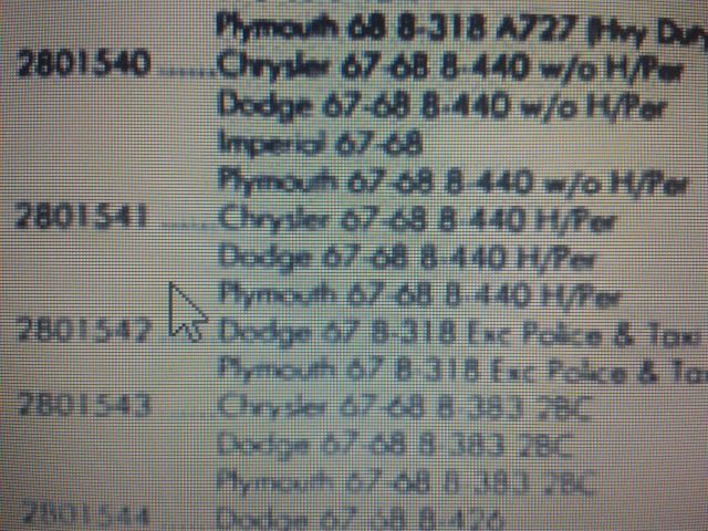

here is a picture I took of the only website I found with part of the number on it.2801541.
totally forgot about it and cant remember what website it came from.
