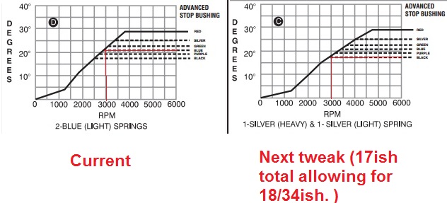

Very impressed with the MSD supplied stuff. Chose blue advance stop and 2 x blue springs, set initial to 14deg. At 3000rpm on the nose she was all in at 36degrees. Lovely.

MSD curve sheet. Very helpful.

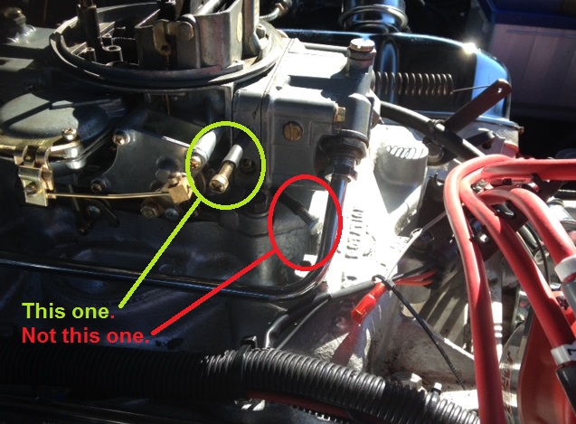

Connected vacuum here -

The van can is adjustable thru the little hose nipple, find a small Allen key to fit inside and locate in the adjuster and back off the advance.

Might try adjusting to black adv busing and silver springs then - see if Ades 18initial with 34ish changes anything.
