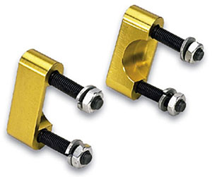

Q. Why 4 inch or 3 ? Or is it 3.5
The 1350 has these silly looking U bolts to hold prop on.
If I'm correct your car Jim has blue billeted like main caps.

Posts: 22137
U bolts are a LOT stronger than the straps on lesser Yokes....
Pete wrote:U bolts are a LOT stronger than the straps on lesser Yokes....
Thats a bit pub quiz cryptic what does one mean Sir ?
Posts: 6740
Straps are profiled steel that fits over the UJ, these tend to be of thin material (Approx 10swg)
Where as a U bolt is manufactured from much thicker bar (approx 1/4") which wraps around the UJ.
Hence the U bolts are stronger than straps.
As I have said before, power does not have friends & will always find the weakest link.
ie No point upgrading to a 1350 if its not retained properly,
Got it
I have u bolts then they just don't look up to the job
Leant so much thanks all

The size is worked out on the max rpm, the more rpm the larger diameter due to centrifugal flex, and I use strange U bolts.
