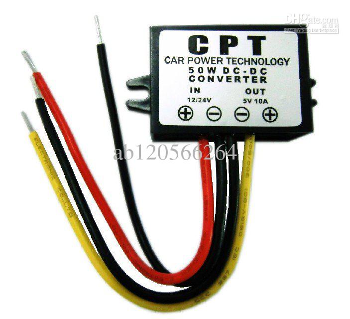

Finally got round to fitting the voltage regulator given to me by Derek, put everything back together and one the fuel gauge only works when the sidelights are switched on
Everything else seems to be ok though, any ideas?

Posts: 5235
how about oil and temp gauge, do they behave the same?? only work with lights on
if so I would suggest your voltage reg is getting it’s 12v from the lighting circuit instead of ignition switched 12v
