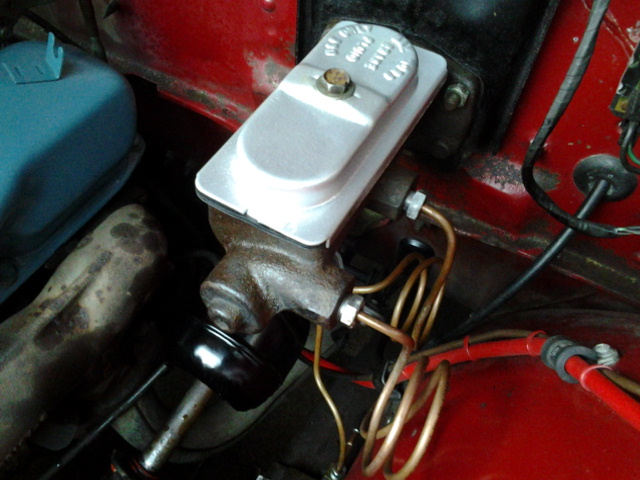

Just for your info Nick, I recently changed my old single circuit braking system (all four brake lines are fed from a single reservoir) on my Fury, to a more modern (and mandatory from about 67 onwards in the US) dual circuit system. The rear reservoir feeds the front brakes and the front reservoir feeds the rer lines. If you have a failure in a pipe at the rear, the fronts will still work as its an independent 'circuit'.
Here s a couple of pics so you can tell the difference if you look at someone elses car....
Cheers Steve :thumbright:
dual circuit master cyl.jpg (160.35 KiB) Viewed 1019 times
single circuit master cyl.jpg (53.68 KiB) Viewed 1019 times
