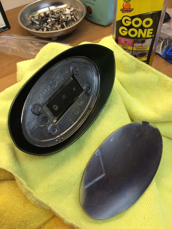

Has anyone got any tips on how to remove/replace the glass in door mirrors?
Don't want to break it out if there is a better way.
Glue a new Mirror over the top of old :?
The only thing I can think of is to boil it in a pan (when your wife's out) til the glue gives up.
I've not tried it but it might work?

is it bonded in or is it popped in?
mine is popped in
the glass is too small for the shell lip by about 1/2 mm
it has a plastic surround that is bigger than the lip of the shell on its outer profile and smaller than the glass in its inner profile
i push the glass back against the spring which takes it out of the inner profile of its plastic frame which usually stays in place round the inside of the shell opening
twist out the plastic frame
and the glass is free to come out
the plastic however gets brittle and nobody makes em anymore
the spring inisde provides pressure to keep glass in at one end and pressure on the ball and socket for the mount onto the mirror stem at the other

It's bonded. If it is the drivers side remote adjustable one that's broken you have your work cut out.

Heat is usually recommended when I've seen this question asked. I did my passenger side with a heat gun OK with this method. But I couldn't do the drivers side, in the end I broke the glass to get it out. But if it's knackered I guess that shouldn't really be an issue.
The glass is held on to the metal backing plate with four spots of black adhesive. Trouble is the metal has a lip all around the edge which makes it VERY difficult to get something underneath it, like a flat blade or a wire to cut the adhesive (like when doing a windscreen). I tried that with limited success

How about using a heat gun, then using a small suction cup (the type used for pulling dents out of body panels) to get the glass off???

Decided to try something I read online and soaked the mirror in Goo Gone and left overnight. Had a look tonight and the glass popped out easily in one piece! Straightforward swap for new glass now as the silvering has gone on the old one and I can now tighten up the mirror as it had become 'floppy'.
