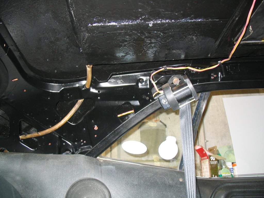

Any install pics. My concern is that the retractors wil need to be angled back and the aftermarket ones I see require a vertical retractor set up
Same here, the mounting points were all there.
I just put lap belts in the centre seats though.

i got a set out of a SsangYong Koranda in a breakers. I tried the original statics and they are awful, couldn't reach the steering wheel.
These are 3 point inertia reel, just had to mount them on the heel board with a captive nut welded to a thicker plate, and use the other existing mounts.
Safety wins over originality with seat belts.

Got Securon 3 point inertias on mine - you can angle the whole retractor as long as you have the adjustable bit on the back vertical ... hard to explain but not difficult to achieve! I'll dig out the part number and web link when I get on the laptop if you like.

Thanks mate, good pics. I was hoping to use a set up with the retractor at floor level as it looks cumbersome up in the roof line.
