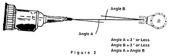

sinny wrote:Angle of the pig & trans are almost dead straight.
That won't work.
Trans/crank centreline should be angled slightly down towards the rear. Pig should be angled slightly up at almost the same angle towards the front (but very slightly nose down from that angle).
You need something more than one degree and less than three degrees angle in the UJ at each end to run smoothest. Under load (driving) the nose lifts slightly hence you need it slightly down from the correct angle when static.
If the UJs are not at the same angle each end of the prop when driving they have to flex at two different speeds and cause vibrations.
