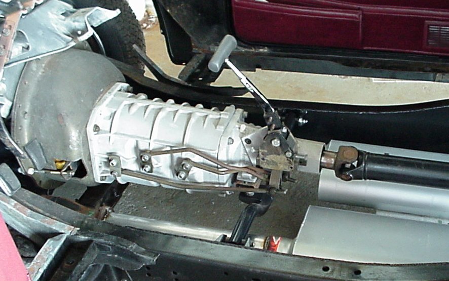

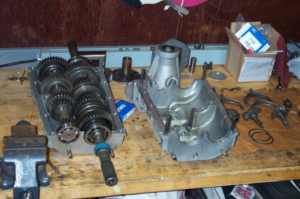

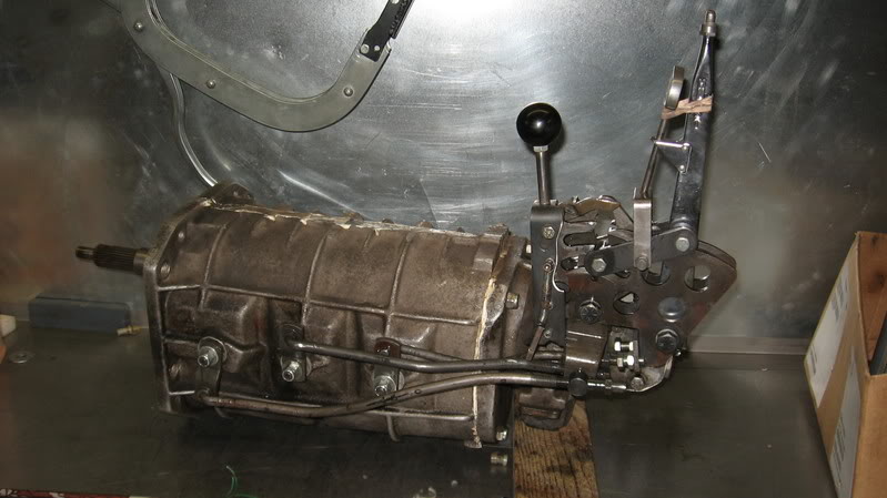

Anyone got any experience of these manual gearboxes?
I've seen a race one for sale and it seems a good deal but I don't know how much of a pain they are on the street.
They're a 5 speed really, with a low 1st so you can gear them to make 5th effectively an overdrive.

I've just learned that the trans I've been offered is non-synchro.
Just how hard would that be to drive on the street?

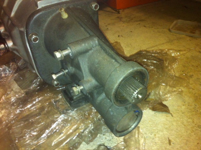

Doug Nash went under and were bought out by Richmond who still sell basically the same thing.
The street and race though they look similar have no interchangeable parts.
The race has straight gears, no synchros, different rear mount (due to the 'torque tube' setup protruding from the rear).
Loads of different 1st gear ratios are available (this one is 3.25), 5th is always 1:1.
General opinion is don't use a Hurst H shifter, use a long V gate.
Front flange has multiple holes for different bellhousings, they all come with 18 spline input as standard.
Above pics are all street model. Pic below shows torque tube protrusion on race model...
