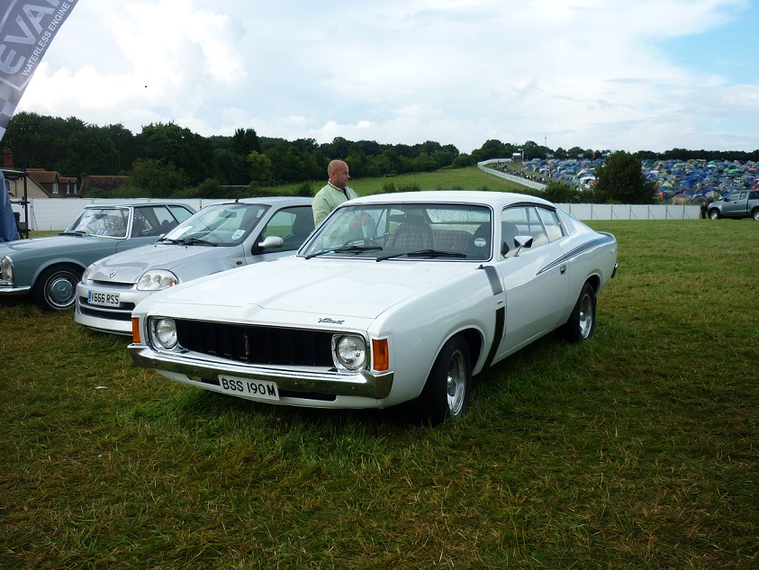

Yes aussie pete that is the car, not taken many photo's of it yet, but here is one...
I also have a Holden HZ Kingswood ute.
Dave999, thanks for the heads up that you have a converter, will bare that in mind, need to get the car looked over before I get anything done to it. I was in Sydney late 1999 through 2006.
I do need to get a new pair of rear tyres , currently she has Goodyear Eagle GA – P215 65R14 96H, any suggestions ? - she has Simex SM800 – 215 65R14 94H on the front and they have a fair bit of tread left.
- 20150321_143311 - Valiant Charger (1362 x 766).jpg (241.84 KiB) Viewed 1983 times
