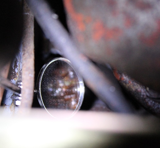

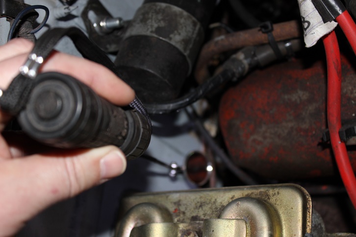

Bought me a Rolson dental mirror from Maplin plus pentorch and went investigating.
It is clearly the cylinder head core plug that has the leak. Has corrosion plus a load of gloopy goo oozing from it.
Beginning to think my old Lotus was not so much of a pain in the butt after all - and that's saying summat!
Thanks for the advice everyone.
Gunge on plug
Gunge on plug
Core plug looking grotty
Me with mirror and pentorch
