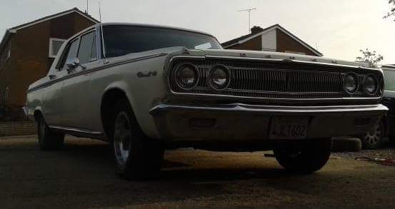

I imported it a year ago, on a tight budget and hoping to get it running and use it...
Originally a 318. The previous owner had fitted a 440 but now it didn't run. So it sat for a few years. I found it on Craigslist and bought it. It only needed a bit of engine work right? Well the car is solid as a rock so only a bit of tinkering will sort it.
Not. :roll:
Ed

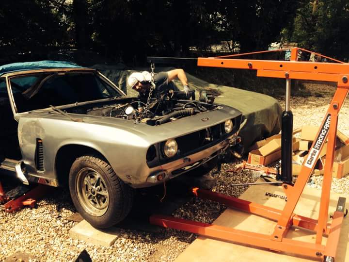

I'll buy another 440. There'll be loads about. Not. :roll:
Tracked a "good" one down in a jensen.
Removed it with one of my best mates on the hottest day of the year..
Ed

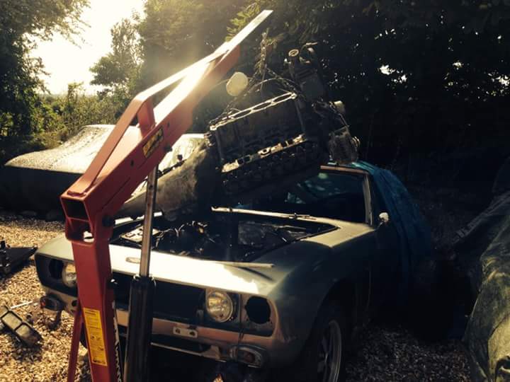

The more I stripped off the "good" engine the worse it looked.
But I had travelled nearly 200 miles and myself and my mate had took a day off work so with a renegotiated price we carried on and took the engine.
The box came with it as a good will gesture for the not so good engine...
OooooHH!
That does not look too good!
Check the heads to make sure they are OK, I think Jensens had a reputation for overheating due to the small radiators dictated by the Hood line....
Good luck with the build, I am just doing a 440 myself....quite therapeutic...

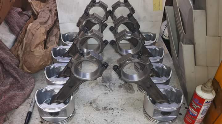

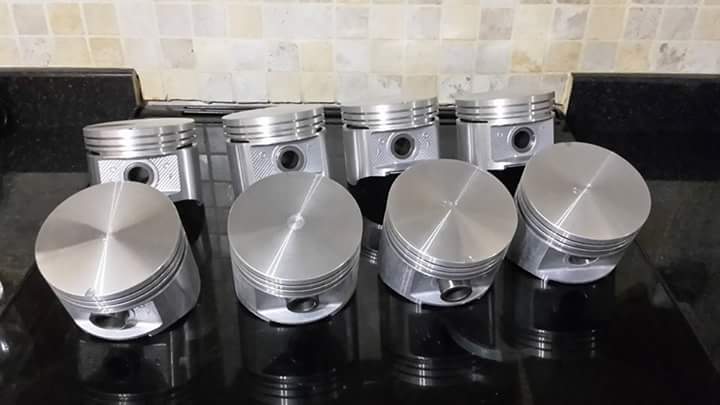

I had a choice. Bite the bullet and proper rebuild or find another good engine.. so I ordered new pistons and a complete overhaul kit from America.
While waiting for my goodies to come alot of cleaning went on.

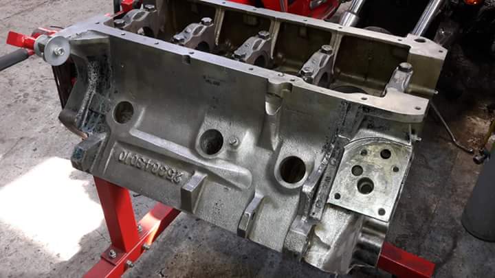

Steam cleaned. And then submerged in a barrel of molasses and water for a few weeks. And then steam cleaned again.
I had heard that molasses removed corrosion bit never believed it. So this was an experiment . And it works a treat. The block is really clean. Not sure if the pictures do it justice really . It was so crusty before. I kept of from rusting again by spraying it with duck oil. And rubbing it lovingly quite regularly. :shock:

Pistons and kit arrived. Took the block to be bored and checked etc.
At a place in Northampton called automotive services. Really happy with their work.
