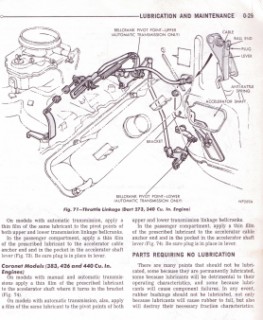

KICKDOWN
Post by DaveBishop »
Here you go
2 x 1969 Dodge Darts
DaveBishop
Posts: 1667
Location: Alicante Spain
Sorry didnt upload
KICKDOWN
KICKDOWN
KICKDOWN1 [320x200].jpg (29.49 KiB) Viewed 487 times
JerryL
Post by JerryL »
DaveBishop wrote:Sorry didnt upload
Unfortunately it's not possible to read the words, though academic perhaps as I'm using a cable, but Ta - anyway.
