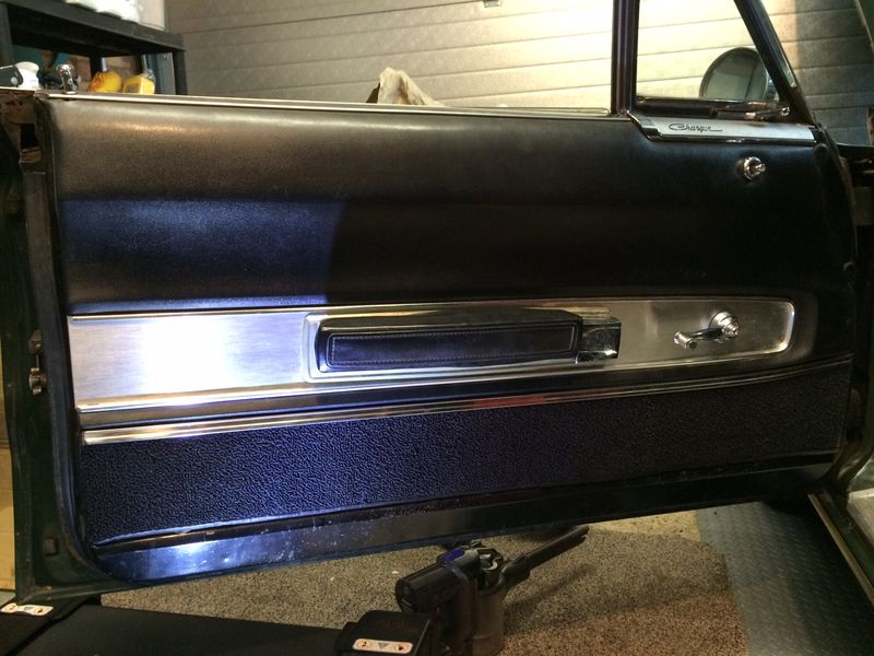

It would be a lot easier with two pairs of hands but I didn't have that option, the jack worked fine though. Just jack it slowly and gently.
I measured as I lifted so I knew how much play there was.
Jacking door.jpg (240.16 KiB) Viewed 864 times
