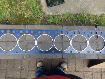

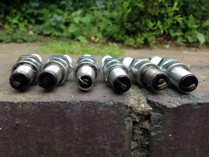

attached pics of
plugs
and a new stanard head gasket
Big holes in middle for pistons
small holes at bottom are for dowels and water between head and block
water return each end as well
no presurised oiol feed through gasket, engine oils through the pushrods
medium holes up top outlined in blue pushrods and oil return
medium holes up top no blue outline dead ended at block. casting sand holes from head, water can get to deck but no further.
Head gasket issues???

all i can think of is that oil is slowly percolating through the layers or under the the gasket across too rough deck at some RPM and getting into at least no.2 cylinder and possibly no.3
or the head is lifting???? ARP studs torqued to spec...!
note even though plugs look orrible decent band on the earth of 1,4,5,6
2 was black and 3 was wet with oil
when 2 came out the hole for compression test it was followed by smoke
and that smoke continued out of the plug hole for a few minutes.

Did you compare the Cometic against a Stock Head gasket to ensure all the hole locations / sizes stack up?

Gasket has slightly bigger bore on the cylinders and needed the dowel holes rounding out slightly other than that perfect fit but lacking the embossing around the dead end water holes. its a cometic so the quality in theory should not be an issue

cracked head?? don't think so no oil under pressure in anything, there is water between the combustion chamber and the oil. i'd excpect presuriesed radiator and bubbles.
oil exposed to vacuum i guess so and the only place would be towards the top side of that gasket between a cylinder and a hole ringed in blue??

the 3 cylinders with lower compression are the 3 cylinders that had worst plugs
one of them smoked when plug pulled out.
Looked into oil migration through or under MLS gaskets on the tinternet
about 14 of an inch distance w
50:50 on opinion as usual
some say yes if the surface is not smooth to 4-5 microinch i think my head is can't vouch for the block
some say yes only if pre igntion has occured
and this is the 3rd time the gasket has been used........ (even if nout much happend in between)
there is 1/4 of an inch between pushrod hole and combustion chamber.
