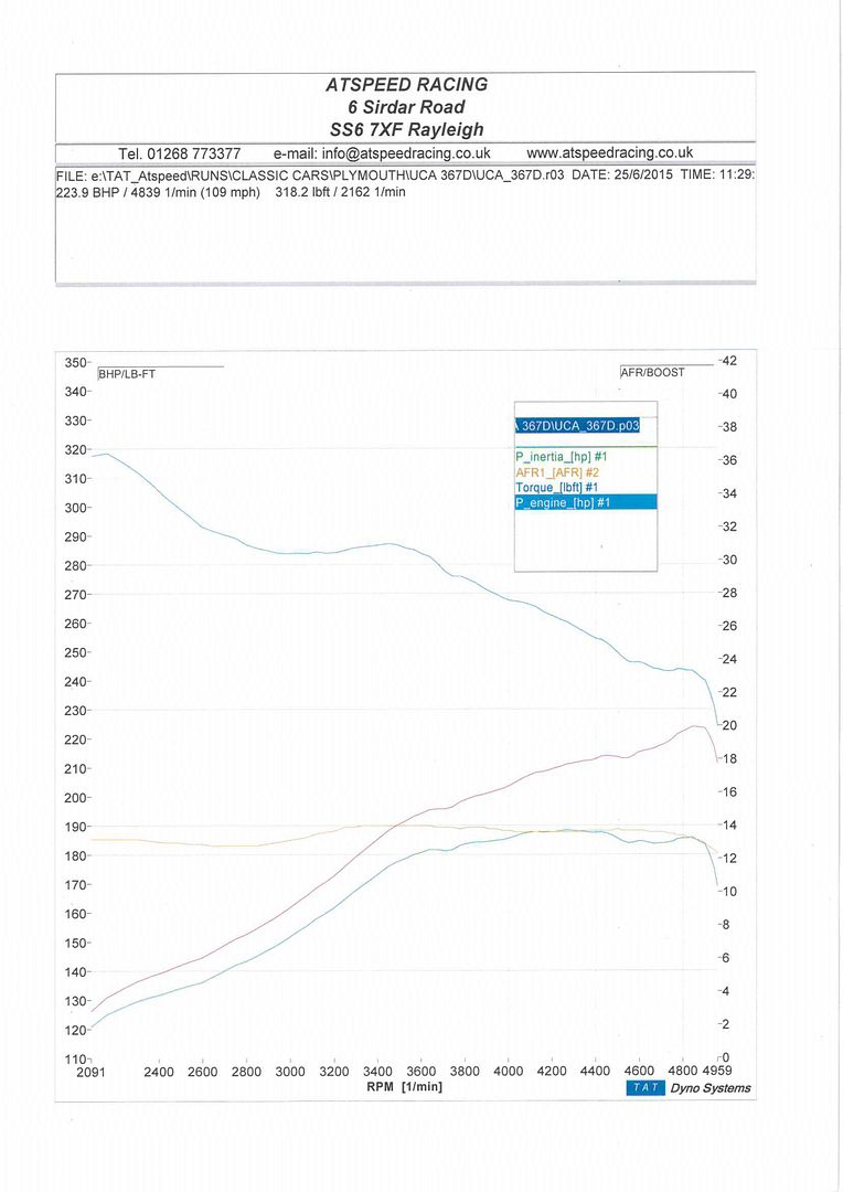

Had my 1966 Belvedere with 440 from a 1970 C body on the dyno today.
Mostly it was just to set the AFR correctly and optimise timing.
All done now and it runs a treat.
Spec of the engine is absolutely standard apart from:
Hedman Tubular Headers
Pertronix Igniter 2 and Flameflower coil
Aluminum crank pulley.
It has a four barrel Carter AFB 750cfm carb.
Well, I was interested to see what she would make, tried not to get my hopes up too much as I know that power outputs in the 60's were often way overstated.
I have the graph I can post at some stage, but it achieved 223bhp and 320Lbft of torque.
This made me laugh really, I have just broken 31bhp per litre.
Quite a long way off the 350bhp and 480lbft quotes for a 1970 imperial or 300c.
It drives well and with non assisted drum brakes and standard suspension you could argue it's enough.
Of course, what have other people achieved??

According to the codes it should be a high compression engine (but not a "HP"), and as far as I can tell it has a forged crank.

Assume this was a rolling road? If so you have to take a few things into consideration. The factory figures you are quoting were probably a bit on the high side anyway, the factory tended to massage HP figures up or down depending on who they were trying to fool. That would also be engine HP not rear wheel HP which is what you would be seeing. The losses through the drivetrain can be considerable and rolling roads aren't especially accurate with true HP readings.
So be content with the fact that it came out running better than it went in and don't pay too much attention to the actual figures.

That's not all loss, there's other things like tyre slippage to consider. Like I said on a rolling road don't pay too much attention to the actual figures, it's a tuning tool after all, you start off with X amount of power and you fettle a bit and find out if you made more or less HP.
Even more losses with a high stall converter, mine made 460 on a chassis dyno at 6300 with mufflers and it was still going up, allowing for stuff i've done, open headers and the chip at 6700 i'd say it's around 500 or so.
Those old factory figures are way off. My full weight challenger pulling 113 mph and change is around 420 hp at the flywheel according to wallace which is pretty close to the moroso slide rule.
The track is the true dyno, run it and then put your figures through the wallace calc and you'll get an honest figure but beware you may be dissapointed.

320 ftlb torque at the tyre is pretty good and nothing to complain about.

true , think from memory the horse power at the rear wheels for a 69 speck hp 440 four barrel magnum was 220 -240 at the rear wheels , depending on what transMick wrote:Assuming a weight of 3850# it takes 224 rear wheel hp, 250 flywheel HP to run 14.5 at 95 mph, that's got to be close to a lot pre emission muscle car times and speeds.
Mick
I believe the hemi was 320 -340
