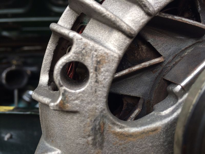

Hi, the belt on my alt needed adjusting as it had come loose coming home from Nats. Had a proper look today and the wrong bolt had been put in as it had stripped the threads. Looked to be 8mm ish but imperial, I tried a stainless 8mm that just stripped it further. When I pulled the bits of thread out I can get a 10mm in but it won't hold. The alternator is quite new (guessing bought last year). Is there a way of repairing this?
Posts: 22109
Can you post up a picture?

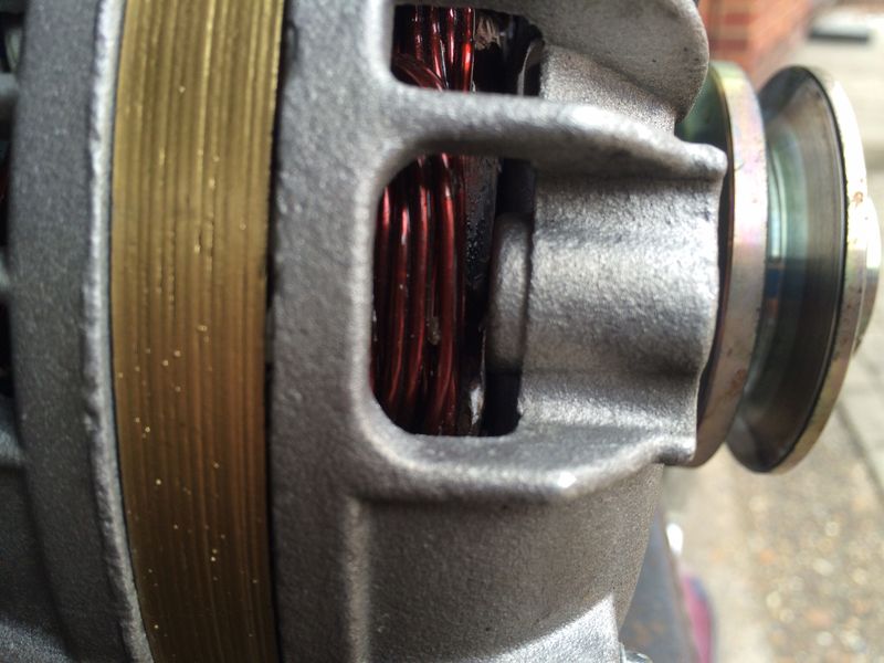

Can you just use a nut and bolt - is there enough clearance to get a nut on the back?
Normally the head size is 7/16" spanner...I think that may be 1/4" or 5/16th" - more learned people than me can tell you........

Got a couple of close ups. First is looking into the hole that the bolt needs to thread into
2nd is side on view of that part. There does not seem to be enough room to get a bolt head in there. The wire is plastic coated but guess it's bad if it's touching an earthed bolt?
