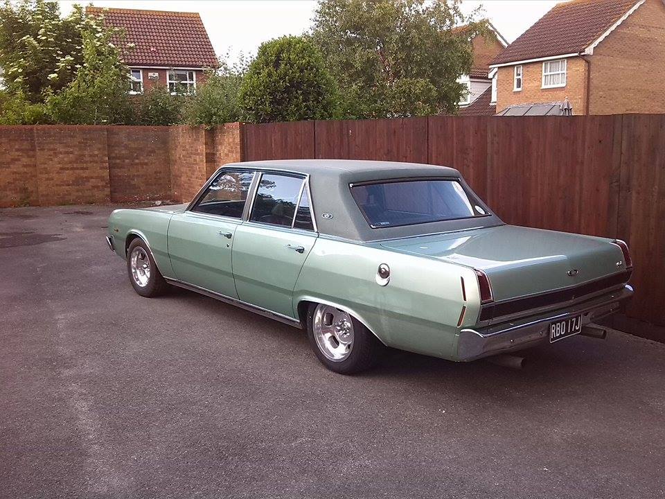

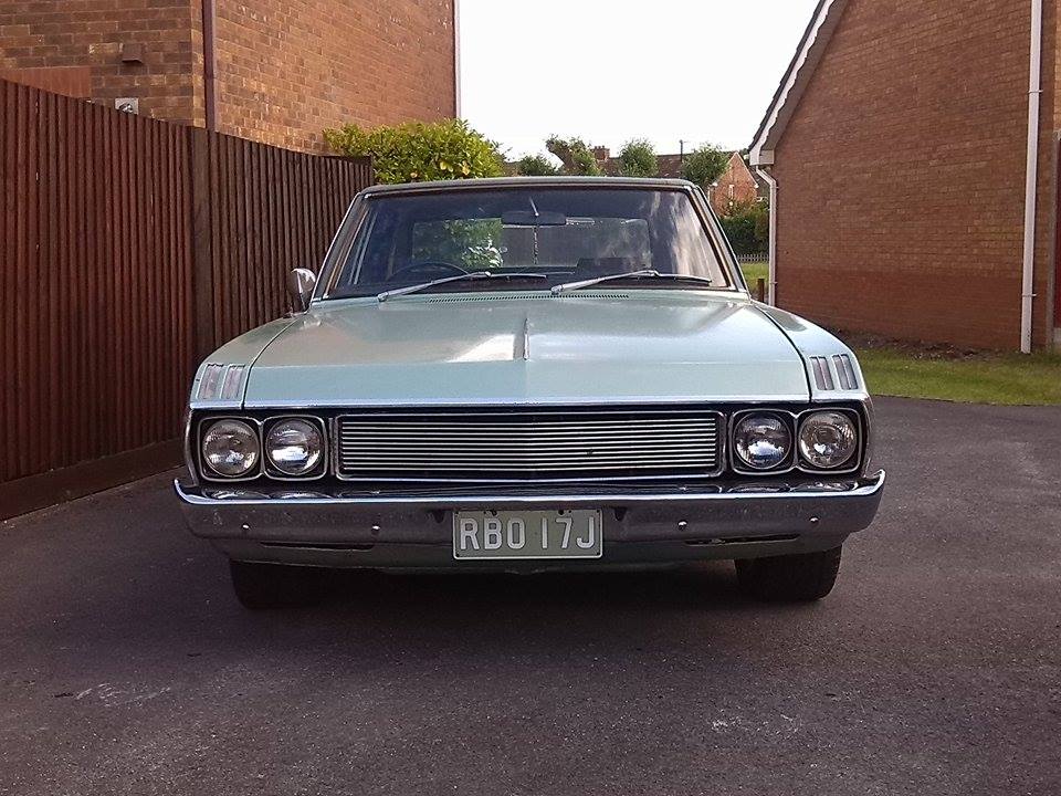

Hello there, I am the new(ish) owner of steves VG VIP from the club, ive recently tidied a few bits up on the old val and rebuilt the old back drum brakes. When doing this i found that i had a leaky master cylinder and was wondering if anyone had any advice on the best place to get a rebuild kit? Cheers!

Gday there mate. My names Richard and Im originally from NZ, living in the south west at the minute and bought the val off ebay start of the year. Had valiants in NZ previously and my brother currently owns a VH 318 wagon back home. Have tidied a few bits on the old girl and chucked some 15x8s on her. Just need to sort out the brake issue now!

Looks great on the new wheels!
Cheers guys thanks for the advice, I think the original master cylinder should be ok with a rebuild kit so if you have a rebuild kit for the VG Aussie pete that would be awesome. If you want to PM me we can swap details and il transfer the money to you? I did see the reconditioned units on a few sites but they are fairly pricey especially when chucking postage on top! Thanks guys
Welcome Richard and a great car. Saw it when Steve owned it and loved it. You have really brought her back to her former glory! Steve was busy with lots of projects and I know he will be very pleased with the work you have done.
I love that met green colour...really works on your car
