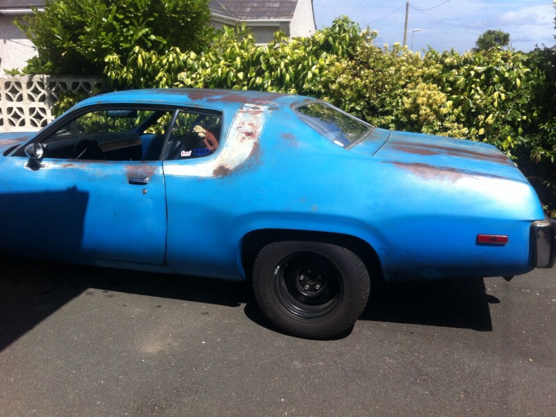

I think I need to replace the rear springs on the Chally. It sags a bit and the air shocks dont hold air and i know they are a bad idea.
Where to get springs then? Is Hotchkiss the only option or are there others.
I will probably need shocks too, so any suggestions on a good all round set up, without going mad?

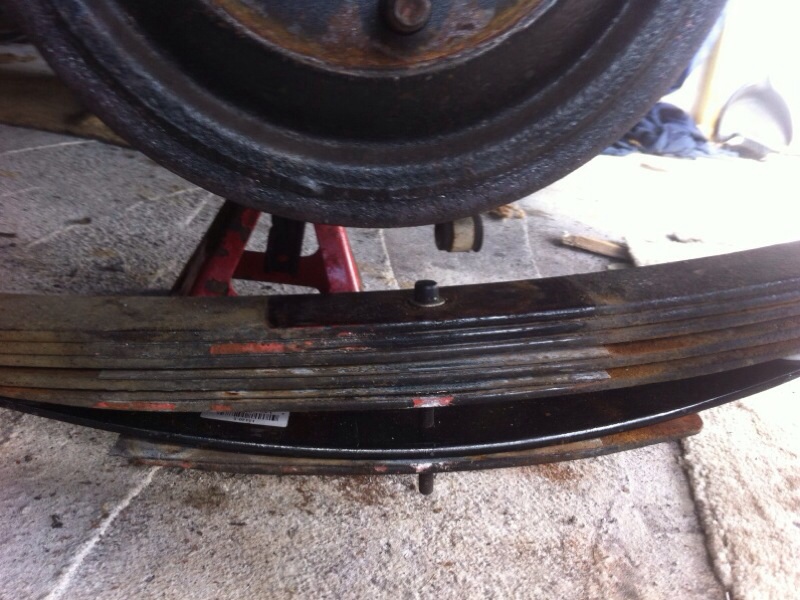

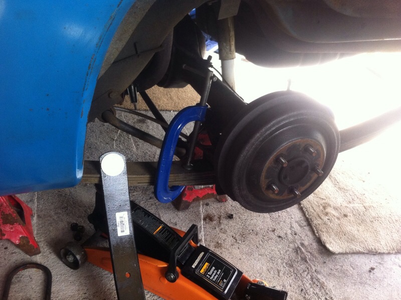

Almost nothing available for my car so I fitted an Add a Leaf set up yesterday. Works really well. Car sits 1,5" higher and rides much firmer. Cost about £35.
Posts: 5893
MilesnMiles wrote:Almost nothing available for my car so I fitted an Add a Leaf set up yesterday. Works really well. Car sits 1,5" higher and rides much firmer. Cost about £35.
That sounds like a plan, I need to raise mine about that, do you have the details of where to get it?
Posts: 7309
Location: Cornwall
Post by MilesnMiles »
Matt, these guys
http://m.summitracing.com/parts/EXP-13120
Easy fix just undo u bolts and drop front spring hanger
