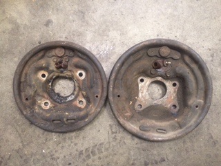

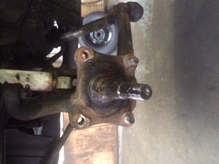

Hi all, Anton has been trying to fit some 10"drums (thanks Pete) to the dart to replace the 9" ones. Here is the problem. as you will see the 2 backplates below have a different spacing for the studs and the spindle size is different. Is there a different backplate I can get that will work? They are small PCD by the way :help:
Posts: 14457
'Fraid not, you have to change the spindles as well, believe the bearings are a different size also. As a rule of thumb all Mopar front brakes have their own specific spindle, 9", 10", four pot disc, single pot, disc all different.
