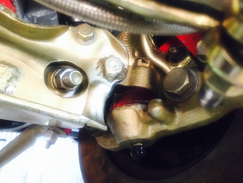

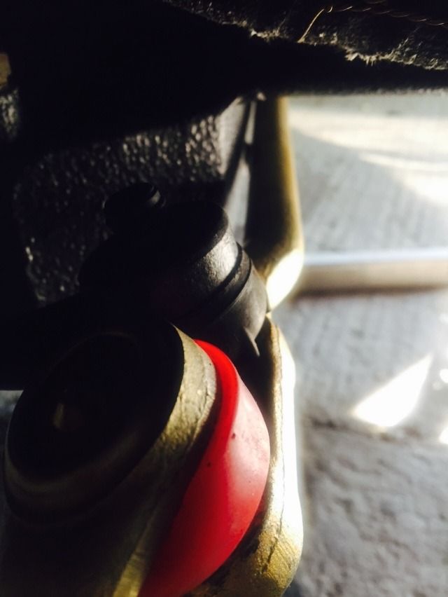

Deep sump is just hitting steering arm before bump stops come into play
Make bump stops bigger ??

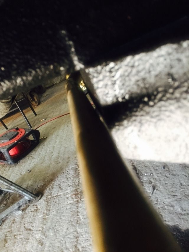

aftermarket never fits ,test first ,,that drag link looks too close to the plug ,not that it will ever fall out ,in my eyes it will always do it up on right hand turns ,right hand turns first tho,no left ,and it should give a nice shinney brass rubbing look too
once on the ground and settled ,it will be cool
hope my advise was good ,if it wasn't she will thrash me with a large encyclopedia
just looked again ,,something is out ,yo drag link should not get that close ,maybe a drive and see what hits ,its like your motor mounts are out somewhere to be that close,maybe the wrong side of the ears ,,very easy done on a big block ,have a look at your trans mount ,if its leaning forward,your engine maybe wrong side of the lugs ,ive seen it done twice now

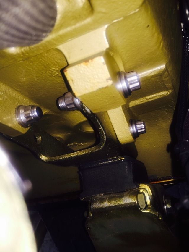

Good idea terry but unfortunately there correct.
Correct side of ears on block
Correctly sided (the one with bolt is drivers side)
The rubbers I believe are not sided and are identical
<a href="http://s73.photobucket.com/user/autofet ... d.jpg.html" target="_blank"><img src="http://i73.photobucket.com/albums/i205/ ... gmmpsd.jpg" border="0" alt=" photo 05BD4252-E282-4301-A0E3-CF3E0567CC90_zps6lgmmpsd.jpg"></a>
<a href="http://s73.photobucket.com/user/autofet ... r.jpg.html" target="_blank"><img src="http://i73.photobucket.com/albums/i205/ ... nyzkhr.jpg" border="0" alt=" photo 581D01C0-1C25-4DC5-BB2D-3922889CAC89_zpsd6nyzkhr.jpg"></a>

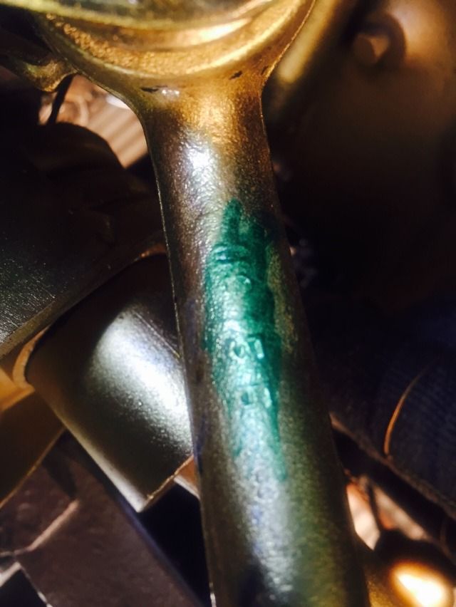

Should be a part number cast in somewhere on that,do a cross reference. Some aftermarket arms look very different to factory parts. Are arms the same on SB cars to BB cars?

You could be onto something here.
The idler arm is definitely shorter than the steering box
WC 15 5
HC 15 5
Any lidle arm licker please pretty please

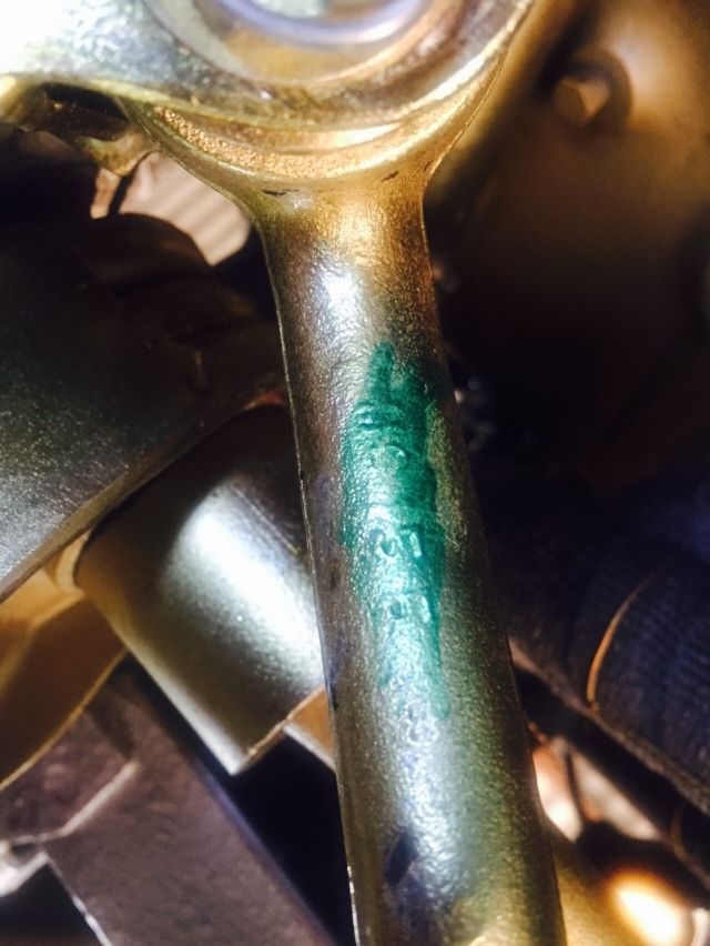

<a href="http://s73.photobucket.com/user/autofet ... 2.jpg.html" target="_blank"><img src="http://i73.photobucket.com/albums/i205/ ... b1d7c2.jpg" border="0" alt=" photo CBCD184E-8EC9-4382-B6B2-59AD7A921A8E_zpsyfb1d7c2.jpg"></a>
<a href="http://s73.photobucket.com/user/autofet ... p.jpg.html" target="_blank"><img src="http://i73.photobucket.com/albums/i205/ ... kefrip.jpg" border="0" alt=" photo E515E620-E162-4BD3-93E2-59D63F4B7C6B_zpsbzkefrip.jpg"></a>
<a href="http://s73.photobucket.com/user/autofet ... k.jpg.html" target="_blank"><img src="http://i73.photobucket.com/albums/i205/ ... wevlnk.jpg" border="0" alt=" photo 55547C77-9191-471F-86AB-39F68AFA93A6_zpsoqwevlnk.jpg"></a>
<a href="http://s73.photobucket.com/user/autofet ... w.jpg.html" target="_blank"><img src="http://i73.photobucket.com/albums/i205/ ... 38r77w.jpg" border="0" alt=" photo 264FF377-E65D-4B3C-AAF6-ABF15BF635C0_zpsuc38r77w.jpg"></a>
<a href="http://s73.photobucket.com/user/autofet ... 8.jpg.html" target="_blank"><img src="http://i73.photobucket.com/albums/i205/ ... wurqq8.jpg" border="0" alt=" photo B7B933D8-17E2-4F0C-8697-60EC93DD12BD_zpsv1wurqq8.jpg"></a>
WC 15 5
HC 15 5

This is brilliant thank you for all the input
So looks like I have a standard correct idler arm
Did find this
I take it that's it's longer ????????
Description: Proforged fast ratio idler arms are direct replacements designed to quicken your stock steering ratio from 16:1 to 12:1. These arms when used in conjunction with the fast ratio pitman arms will improve your stock steering from 3.5 turns to 2.75 turns lock to lock. This quick ratio was previously found on rare AAR Cudas and T/A Challengers. These idler arms are made from forged heat treated steel for rugged durability and black e-coated to prevent rust.
