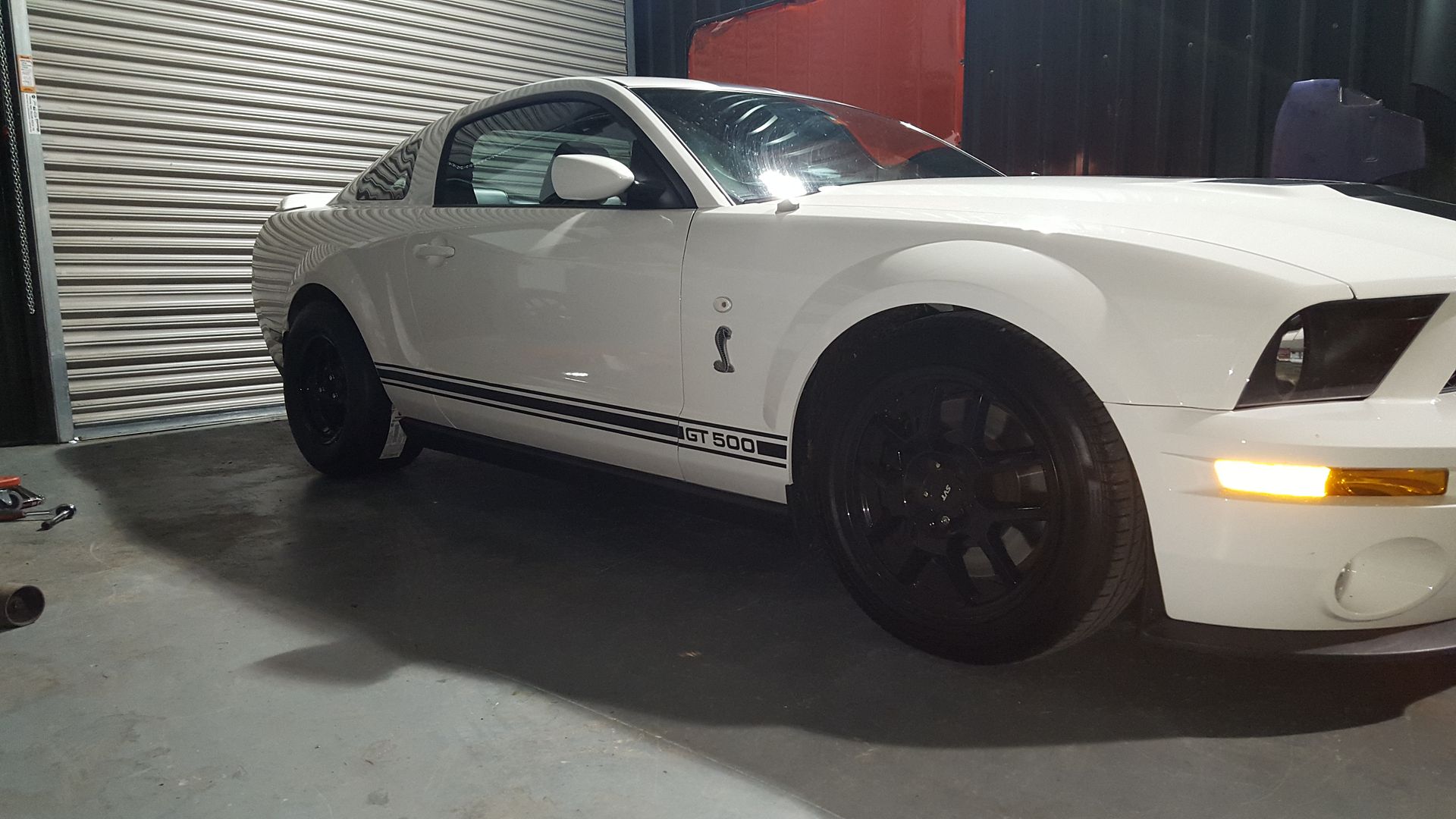

Well im not sure how it happened, but me and the wife ended up with fraud.
But jokes aside its been a good car and has impressed us but its still not like the old stuff...
Its a 2007 Shelby GT500, the first year model come back of the Shelby Mustang line. Production for 2007 were just over 10800 with around 2000 of them being in performance white, all hand built at Ford's SVT line.
And so after weeks and weeks of saying we are not modifying it in any shape or form we decided to do just that...... but restricting ourselves to bolt on's only so the car and be put back to stock easily.
This thread will follow the work and progress of the car with minimal bolt on's and simple changes to lower the E.T's just to see how much we can get out of the stock motor, stock blower with a stock pulley set up.

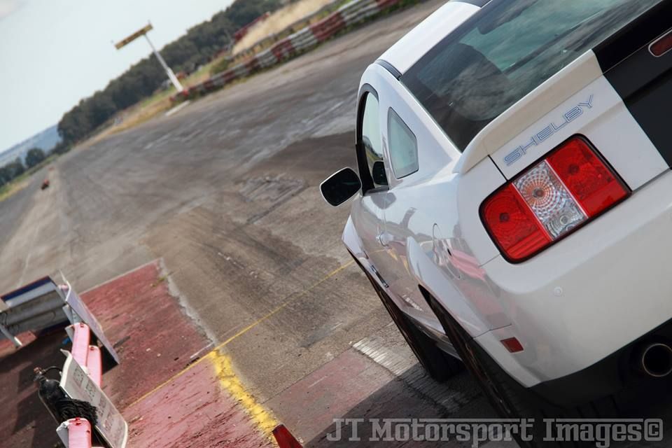

We ran the car at York Raceway a few weeks ago for a day and with it being around 4 years since the miss's last had a run in her old 9 sec nova, so there were a few cob webs to blow out.....

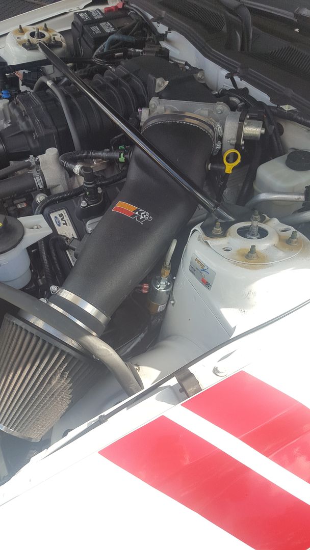

So with stock treads, traction control on, a bolt on k&n and on the dirty side of Yorks track (clean side for slicks, unprepped for treads) it managed a high 13 with mass's of wheel spin even with the TC on.
Not to shabby but was expecting a little better, now time to make some changes to get all that factory power to the ground.
With 500 crank hp standard it aint slow (alougth the 4000lb weight is a disadvantage), at present its running a stock map with air intake upgrade and straight piped (all bar the cat's which are to be deleted hopefully this week, more on that later).

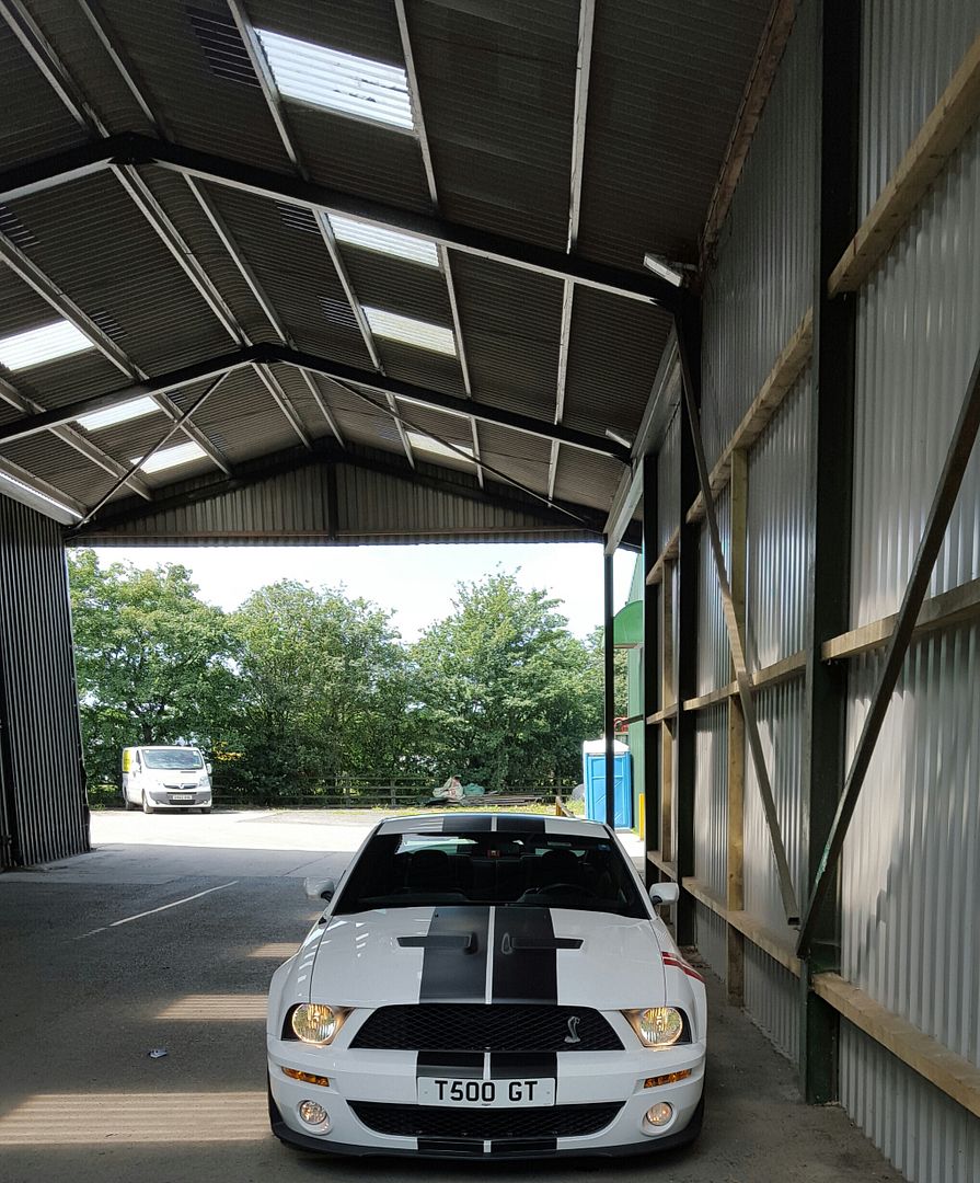

How come the shop is so empty pete ??/ where is the Dodge,,
That's the access road to the workshop, not the workshop itself Duncan.
Pete wrote:That's the access road to the workshop, not the workshop itself Duncan.
under cover ???

yea the farmer use's it for cover when spuds in trailer etc also handy for washing cars when raining :D
You would have driven though it when you came down Dunc.

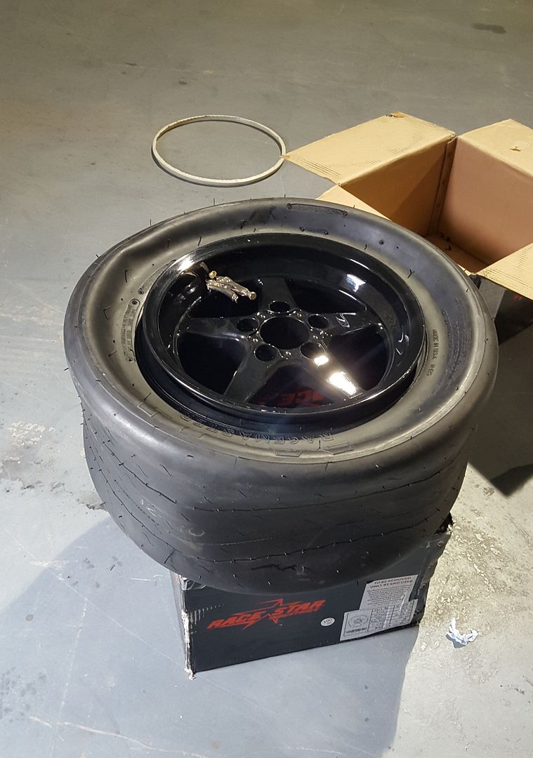

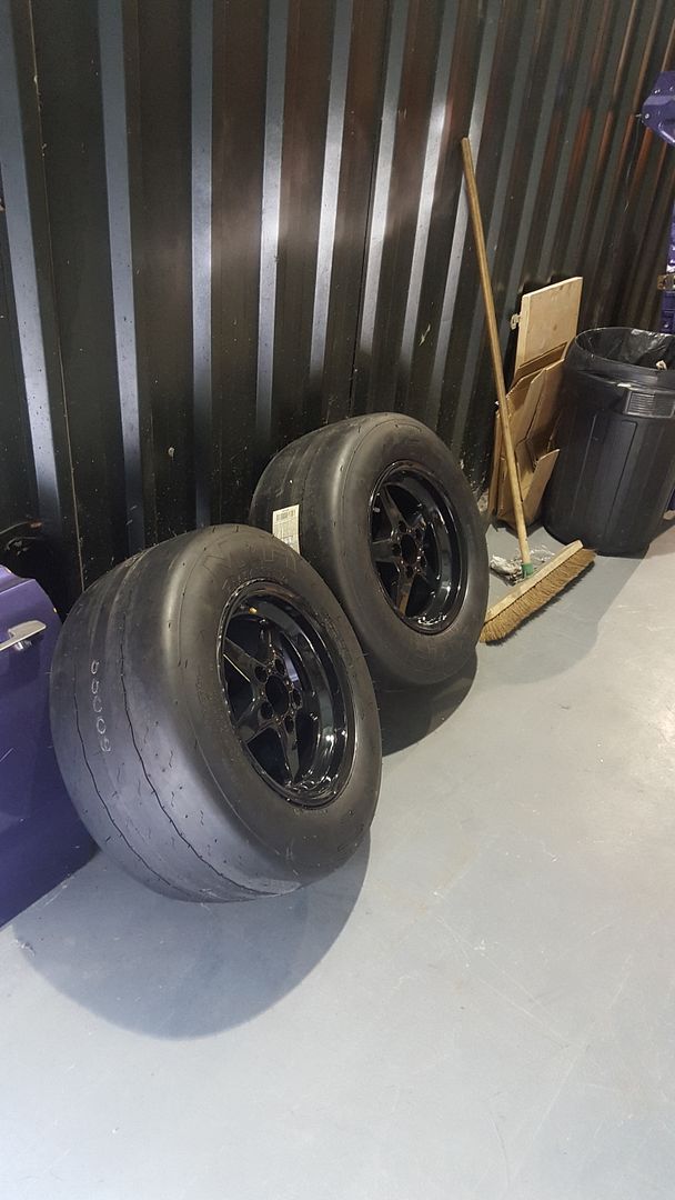

The first step was some better tyre's, at first i was going to go for a set of MT drag radials due to the rounded shoulder for good clearance.
In the end i went for a set of M&H cheater slicks which also have a good rounded shoulder but with the benefit of being a slick (or near as).
This aint so easy fitting 15" rim on a modern muscle car due to the car being designed around 18" wheels, as luck would have it the rear calipers are small enough to miss the 15" rim but the low slung anti roll bar is right in the way of a 10" wide rim, an 8" would have cleared but i wonted to go for the 10". So we made a set of relocation brackets to move the bar about 1" up inside of the 15x10 rim.
I also opted to run an inner tube in the soft wall tyre due to the fact we are at factory weight.

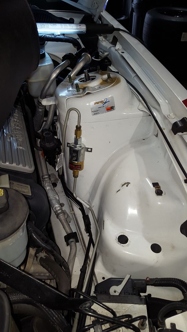

Second step was a line lock, obviously so we don't cook the rear brakes in the box and also to act as a roll control when staging the stick shift car, this was another item to stop potential drama's when staging.
Again this was done so we retained the factory brake line (now in a box) and a neatly hidden black momentary button was situated on the center console down the side of the handbrake out of sight. Its sits in a right good place, comfortable to used and easy to move to grab 2nd gear with no drama's.
