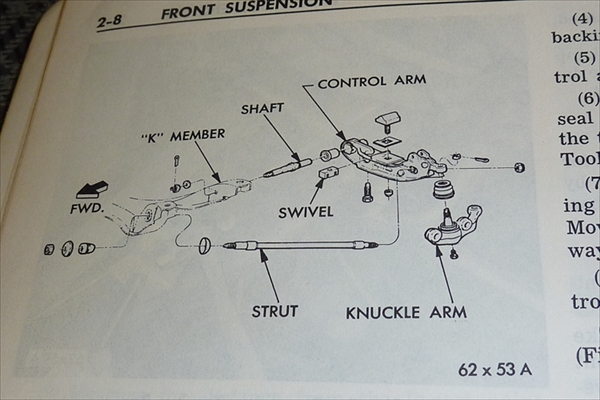

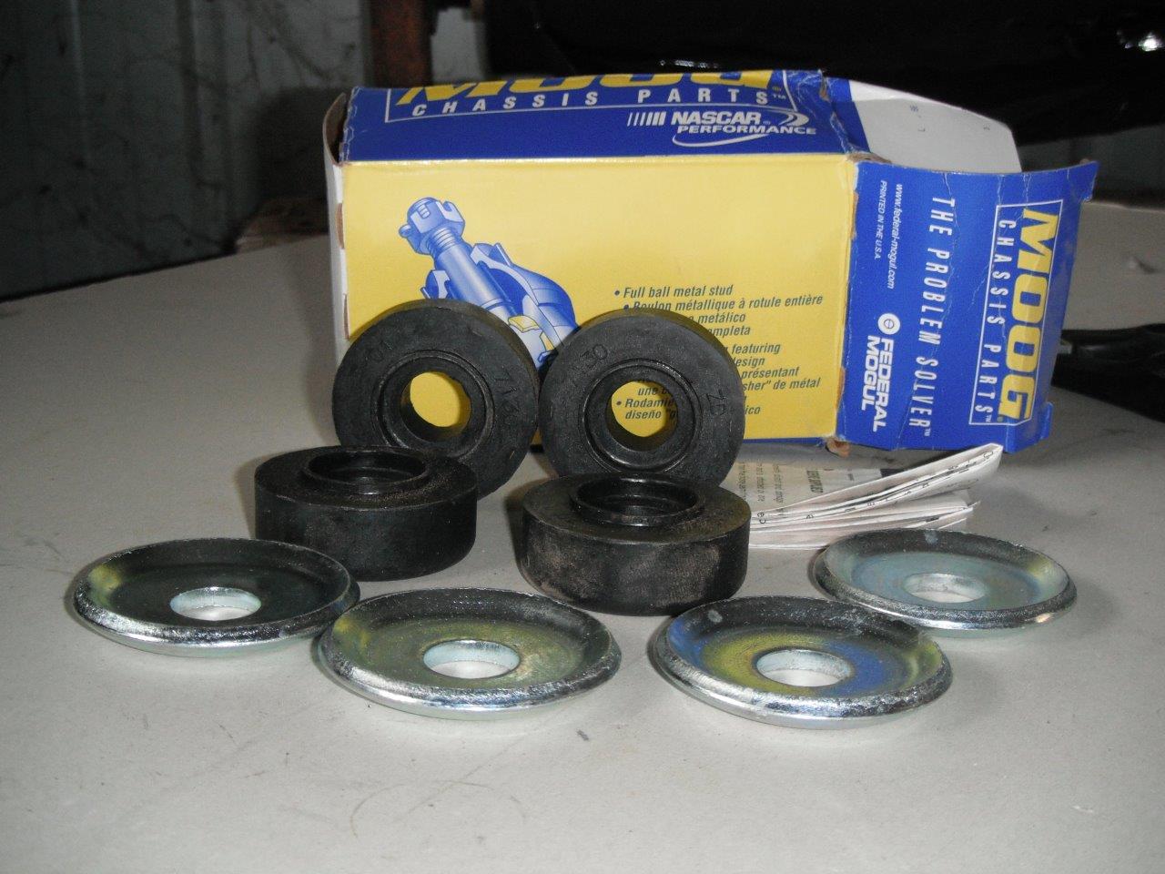

Thanks guys, i just had another look and, having presumed they'd be like those Moog ones in the pic i attached, the FSM shows the bushes to be more like the ones Steve posted off that Ebay link. Thanks Steve.
I would appreciate if you could have a look Rebel, but they'd need to be like the ones on Steve's link.

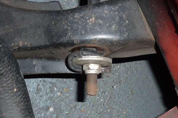

I'll try to get the parts first then think about fitting. Pic below shows the one that's knackered - driv side, pass side not too bad. Is it best to keep off the road till it's fixed?

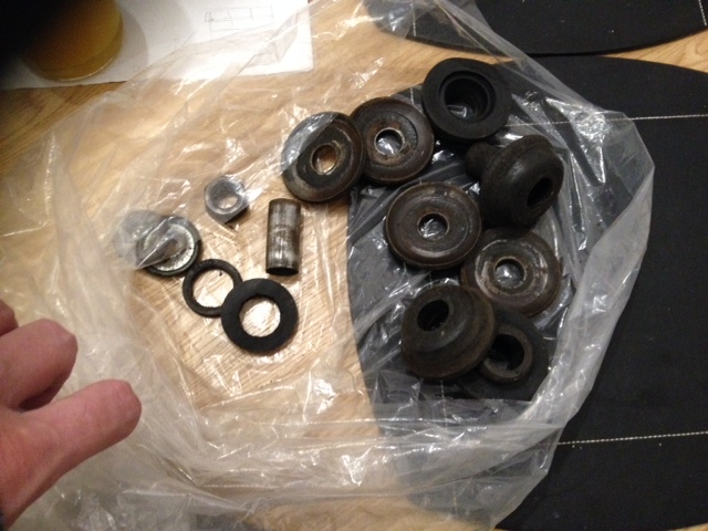

Got these. Came off charger. Think they are right.
Changed due to complete rebushing of everything rather than because they were actually knacked. If they are right (a quick peek under front of car suggests they are) they are yours if you want em...
Collect or post...

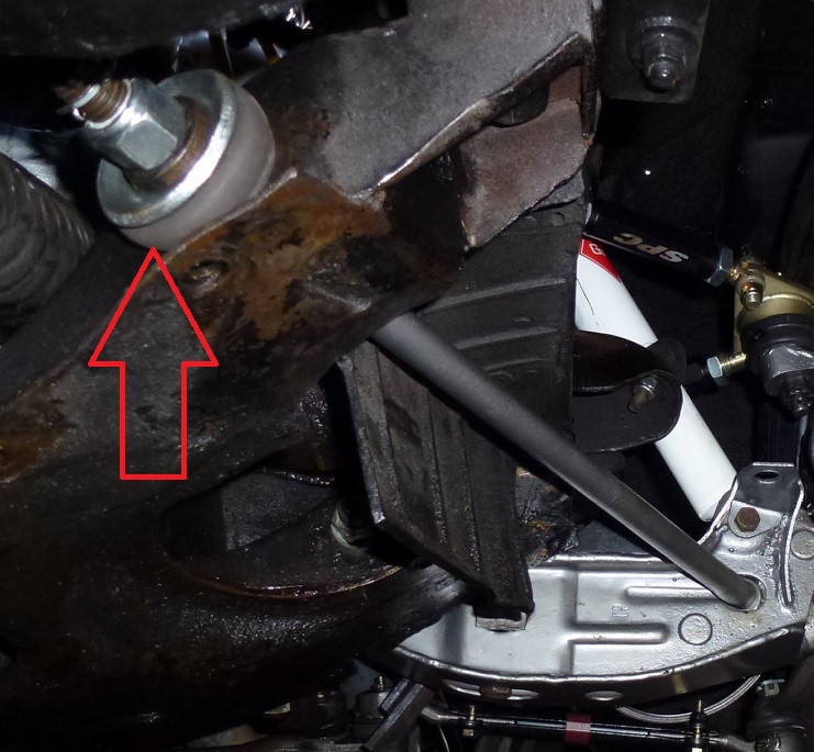

I think there are 3 types of bushing you can buy in rubber at the moment
2 types that are made up from 2 rubber bits a set of cupped washers and a tube
and 1 type that is a single press fit bit of rubber
the problem starts with the first 2 types
1 kind was specifically for 60s A bodies and has a thinner rubber doughnut facing the rear of the car up against the Stop on the strut with a fatter bit on the K member
early A body struts have that stop in a slightly different place
most you can buy are 1 piece or B body E body kits so the chances of getting some that don't fit is low
the chances of getting some that don't look anything like what was put on, on the production line is high because they changed them and the latest versions are the one you can buy from moog
the single push fit rubber persisted in Australia for longer not sure if it was early or late fitment and appears to still exists just to cause confusion
they are seemingly a pig to fit
if you fit it all up and it pushes the lower A arm back too far you will not be able to achieve a desirable smidge of positive castor.
this is not relevant to you car but has some nice pictures to show you the part and the fun somebody had when they had the wrong bushings
http://www.heritech.org/cuda/bushings.html
