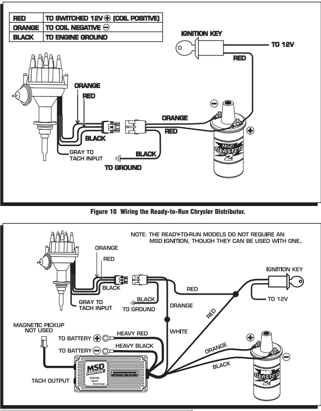

Posts: 4226
Here ya go. This suggests 12v - no mention of ballast... (this came from the manual for my ready-to-run, but seems to cover modules too)

Post by GJUK »
morgan wrote:Here ya go. This suggests 12v - no mention of ballast... (this came from the manual for my ready-to-run, but seems to cover modules too)
Thanks, on another forum they suggest connecting the brown and the blue cable which went to the ballast, then run the MSD switched igntion to this.
brown is ign 1 and blue is ign2 or something like that, one runs 12v only when starting, the other 9v or so when running. Together they supply the required 12v to the MSD. :read2:
