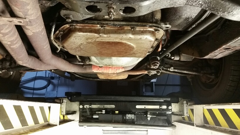

My Charger has has a whack underneath at some point so I will be having a new piece of exhaust welded in. The trans oil pan looks like that has also taken a whack and has a leak, the guy that will be doing the exhaust says he can weld the oil pan too but I'm just wondering if I might as well just replace it? Summit racing do one but it has bad reviews. Either way I'm pretty sure I'll need a new gasket anyway? I've noticed a clonking noise from underneath the footwells when driving it which I'm guessing might be linked to.the oil leak. Any advice would be much appreciated. Thanks.
- 20151016_170841_resized_1.jpg (164.21 KiB) Viewed 1521 times

Personally I would replace & fit a drain plug at the same time to make future oil changes easier, something like this http://www.ebay.com/itm/Skyjacker-High- ... W1&vxp=mtr the clonking noise is unlikely to be related to an oil leak, more likely the exhaust hitting the floor or a broken transmission mount or both.
A904 pan..........http://www.manciniracing.com/mopa9anda9no.html
Maybe drop Dunc an email........he's the trans Man and may have a pan off a broken box.........Cannonball is his username!
To remove the flat spot the carb needs adjusting and possibly the timing is out. I would also just dress out and dent in the trans pan and put new gasket and change the fluid and filter at the same time. The exhaust can be repaired locally too. No big deal.

Ooh that sounds a bit complicated about the flat spot. Will have to take it to a garage for that. If I decide to replace the carb is Carter an aussie make? If so I guess that will have to come from Pentastar?
One more question, the exhaust is blowing quite badly from near the manifold and there is a visible hole - could this contribute to the flat spot??
I have a new pan coming with a service kit (from Woolfe Racing in Bedford) and I will buy 6 litres of Dexron III trans fluid. The same guys that are replacing the pan for me are going to give me a price for fixing the exhaust. I did find this bloke on Facebook called Weld Done and he quoted me 40 quid to sort the exhaust but he seems to have vanished and his phone no longer takes calls.
Thanks for all the advice everyone, much appreciated. I hope to get the car fixed up soon so I can take it to the Mopars at the Pod next year.
