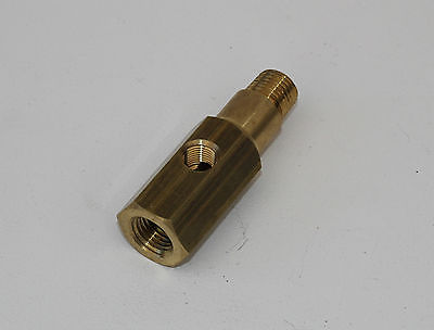

I’ve not done it but I believe you can get water and oil bosses that have dual outlet so you can run the original sender / original gauges and the mechanical gauges as well

I run one of those dual senders, to keep the idiot light functioning. Can't be watching the gauge all the time. Poked the capillary tube through the firewall grommet for the accelerator cable, as I recall.

It's the same as that one from Real Steel, though I think I got mine in the States.
Your existing electrical sender screws into the end, and there's a take off for the capillary on the side.

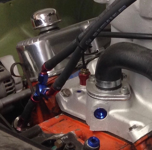

Posts: 14459
That will sort out the Oil pressure gauge, you may have a plugged port on your intake manifold that goes into water that you could use for the temp gauge without disturbing the stock sender. It would be at the front by the thermostat housing. If you don't you'd have to drill & tap to suit.

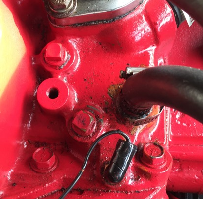

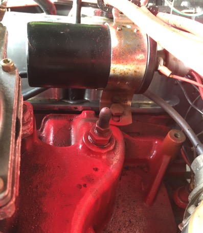

Can I use these two "extra" ports instead of running off a "T" fitting ....
Either of these square nut ports for water temp probe ?
This for oil pressure capillary tube ?

Posts: 22137
Yep, take your pick - or more likely which you can get out. As long as it is in the water jacket you will be fine.

Post by Guy »
The top photo is nothing to do with the oil pressure that is into a intake runner and would only give you a vacuum .
