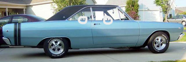

Hi all, what is the best way to remove the side glass lower chrome strips. The area circled. Not my car, web image.Thanks
If you mean the strip that runs across the top of the door, if it's the same as my '71 was then there's a wire clip on the trim that just pokes into a hole in the door. you want something flat and wide like a putty knife to slide under it and carefully lever it off without bending it, it will probably come up a 1/4" or so before the clip releases.
