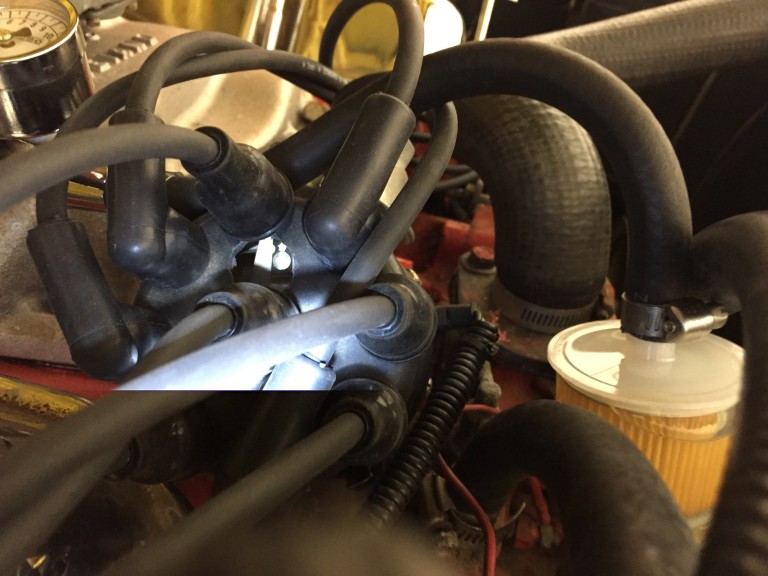

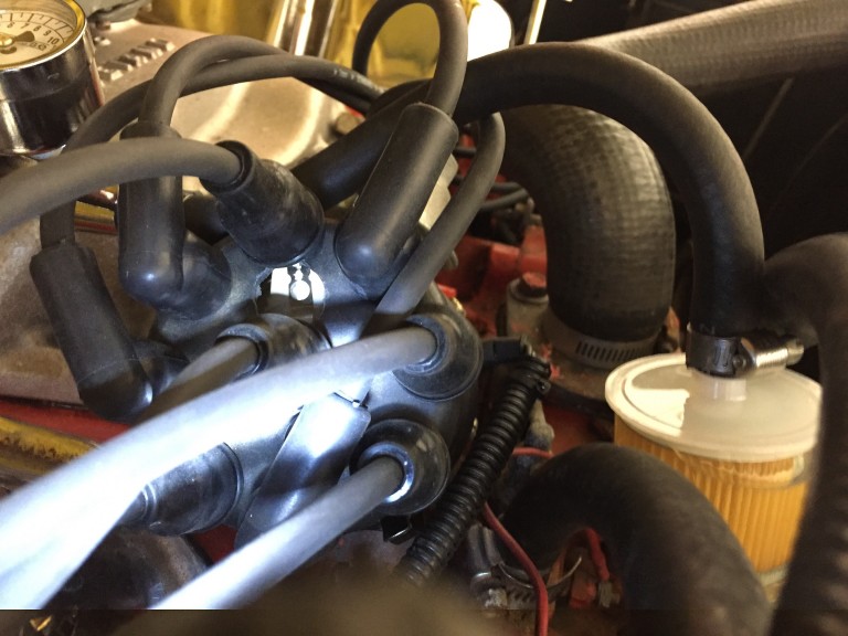

Checked pump, arm and all the cams I have. Considered upgrading to the 50cc pump, 35 seemed big on a 383 for what I've read.
I checked the phasing tonight and it was spot on. I reconnected the vacuum to the dissy and the phasing advances a little. She didn't seem to pop through the carb though snapped her open and little. She Popped through the exhaust couple times, but I think that might be down to the old cap and rotor missing, now and then the light stopped working for a second
I was working in the garage so I couldn't run her for long without killing myself, but this does seem to be an improvement, she's still leaning out on the gauge though.
Anyone got a 38 squirter??
- This is with vacuum connected and a little throttle.

- Drilled the old cap and parked it and the rotor with some tip ex. This is without vacuum
