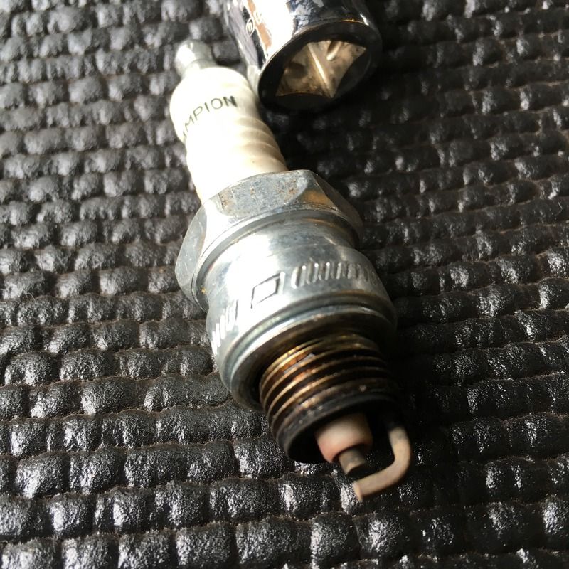

Hi, car has been running great, have recently done motorway driving at 70-80 no issues. Today had a slow drive out to local show, again no issue, but after we went on somewhere else, I'd been at around 70-80 for about two miles then then was a sudden loss of power and two big backfires from the exhaust. It seems fine now and I pulled all the plugs to check, they all look the same as below. Anyone got any ideas what would have caused this? My big fear is if I have or can cause any damage?

In the two pics, the first plug looks OK to me, the second one is a bit darker in colour at the tip, there's no burnt electrodes though and they're not soaked in anything. Might be worth trying just changing them.
Other than that someone with more knowledge than will hopefully be able to help
