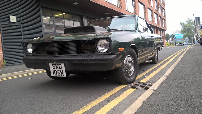

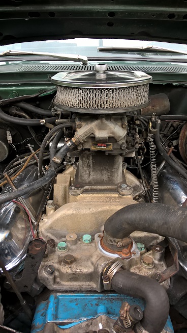

Following recent engine swap (thanks Scotty, Anton) I have the following set up on my 74 dart 318 - edelbrock intake manifold, a vertical spacer and holley carb (im told a 650cfm, carb and spacer came with car from US)
however the spacer prevents the kickdown from being connected
replacement engine came with a edelbrock carb (believe a 600cfm)
should i lose the spacer and go with a flat hood, is it actively helping carburation ?
which carb would suit the 318 better for performance, holley or edelbrock ?
thanks men
WP_20160707_11_14_45_Pro 1.jpg (180.02 KiB) Viewed 1654 times
WP_20160706_16_53_43_Pro (1).jpg (189.16 KiB) Viewed 1654 times
Daily drive - 74 dodge dart hardtop 318 green/black

I'd replace the kickdown linkage with a Lokar cable conversion,solves many problems.
1965 Belvedere 2 426 Wedge.
Dart Vader
Posts: 3532
Location: Swindon MMA180
Post by Dart Vader »
totally agree, the Lokar version is dead easy to fit, never needs any replacement parts and should be compact enough.
Lokar is the branded version but there are others which are replicas
Holley have the general edge regards reputation but Edelbrock is just as good, six of one, half dozen of other. Edelbrock design is different

okay thanks, good to know ... would the motor suit a 650 better, and is the spacer basically just for show or is it worth keeping in place ?

according to this online calculator a 600cfm is better suited :
http://www.csgnetwork.com/cfmcalc.html
Posts: 22109
The sizing is not that critical, and the spacer whilst not the prettiest, it will add a bit of plenum and as you have a dual plane manifold it may help it a bit.

right so perhaps keep the holley, spacer and the scoop, pretty much the opposite of what i thought !

More of a tunnel ram than a spacer! What build is the motor and what rear gears? Any spacer normally moves the torque peak higher up the rpm range. That would work with deep gears 3.91 up, but if only 2.76/3.22 I suspect you'd be giving useable torque away.

hi miles, stock motor, stock rear for a 74 dart ?
i think my approach will be to remove the spacer, run without it on the holley 650, gauge any improvement
after then switch carb and try with the edelbrock ?

Actually what does need emphasising is the importance of having the kick down cable connected. It Must be connected or you'll fry your trans.
I can't see that spacer doing much for the car with stock rear.
Gears are probably 2.76 or similar.
What rpm is it spinning at 70mph?
Can work out the rear gear ratio from that as long as we know the tyre size diameter too.
I.e my old Rooadrunner has 3.23 Gera and 27" tyre and spun 3,000 rpm at 70 approx.
As for carbs, if the Holley is working well I'd favour it over any Edelbrock, but I'm biased againts Edelbrock carbs; fine for easy idle and cruising, but not for performance.
I'd go for Holley on conventional manifold and probably you'll see more torque lower down.
Some years back I bolted on a 1,5" spacer and road tests the car. By seat of pants it was clear that the torque figure moved up the rpm range. I took it off.

right thanks, manifold currently edelbrock performer, hence thinking should be mated with edelbrock carb, i am losing atf when car is stood, let me find out the rpm @ 70mph

Manifold is a manifold. Doesn't have to be part matched as long as the crab can bolt up ok.

As for inlet v carb, I have Eddy inlet with holley carb no probs. As Miles said as long as the carb fits the inlet happy days.
Personally I'd ditch the spacer, it looks like a goose's neck ! Get a holley carb, decent mopar performace air filter and it will look the biz.
