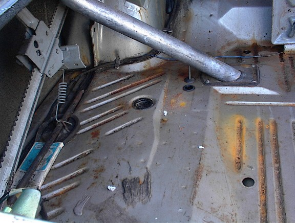

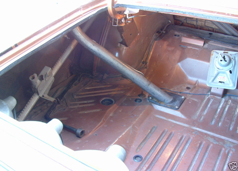

the filler neck vent , is just that it should be left open ,! or should I say , it should be vented to the out side air , the factory set up , was to run it into the rear drivers side frame rail , & that was it , IMO not a good idea , so what I done , was extend the vent tube with a piece of suitable size rubber fuel hose , so its just sticking out of , one of the factory holes in the frame rail , under the car , the smaller 1/4 nipple on the fuel sender , is for a vapour return line , from a vapour separator , if you have one , if you just have a single fuel line , this 1/4 nipple on the sender unit should be plugged .
im assuming that you have the stock OEM , 440/426 , 3/8" & 1/4 " sender.
below is a picture of the stock set up , you can see the vent tube passing through the trunk floor , & exiting into the frame rail , if you copy the way the factory done it , make sure all your floor plugs & grommets are installed , other wise your smell fumes eventually . , this was the reason I lengthened the vent tube to exit through the frame bottom did not like the idea gas fumes inside the frame rail .
side note , have heard stories of a fuel tank imploding / collapsing or what ever its called , because of a blocked fuel tank / cap set up , never seen it my self :?
