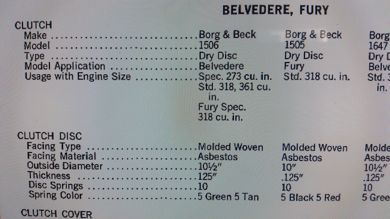

I want to replace the clutch on my 318 3 speed Fury.
According to the shop manuel the A-745 can use a 10 or10 1/2 inch clutch.
Is it a case of either, or…..
The car is in SA, and I want to buy the bits here in the UK. I have no access to it to check what plate is being used at the moment.
Am I a bit thick and missing the obvious ? :read2:

Post by RoelB »
Shop manuel
