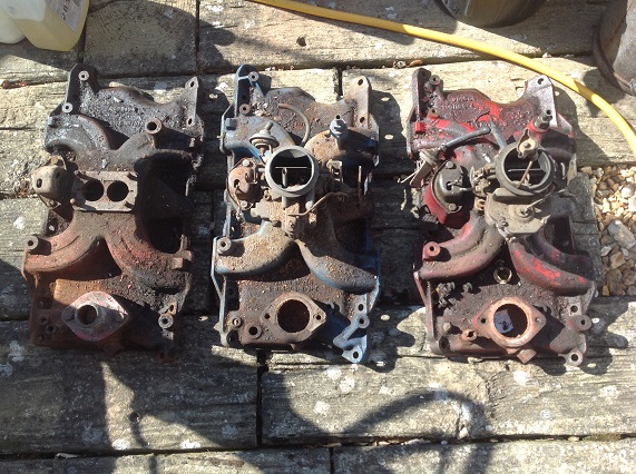

- aussie standard inlet manifold £25 each
- inletm2.jpg (166.91 KiB) Viewed 1331 times
