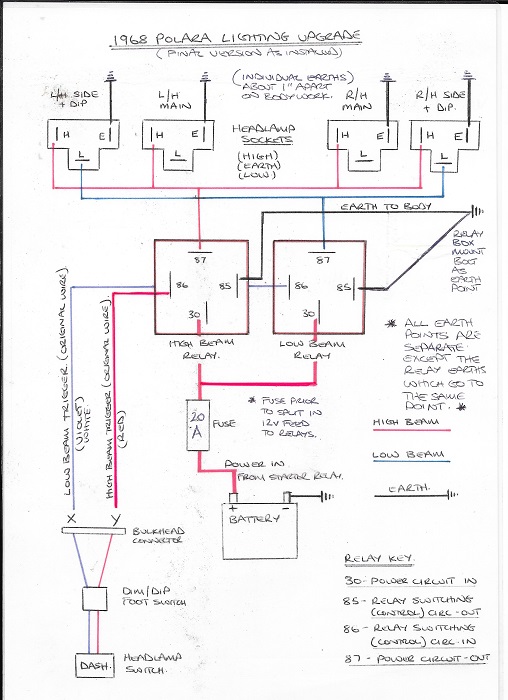

Posts: 7526
Well worth considering a conversion to relays as it just uses the wire from the switch as a low current 'trigger' and keeps all of the power out of the dash switch. Here is a copy of the one I planned and made up for my Polara
Cheers Steve :thumbright:
Polara relay loom resized 1.jpg (114.25 KiB) Viewed 1353 times
