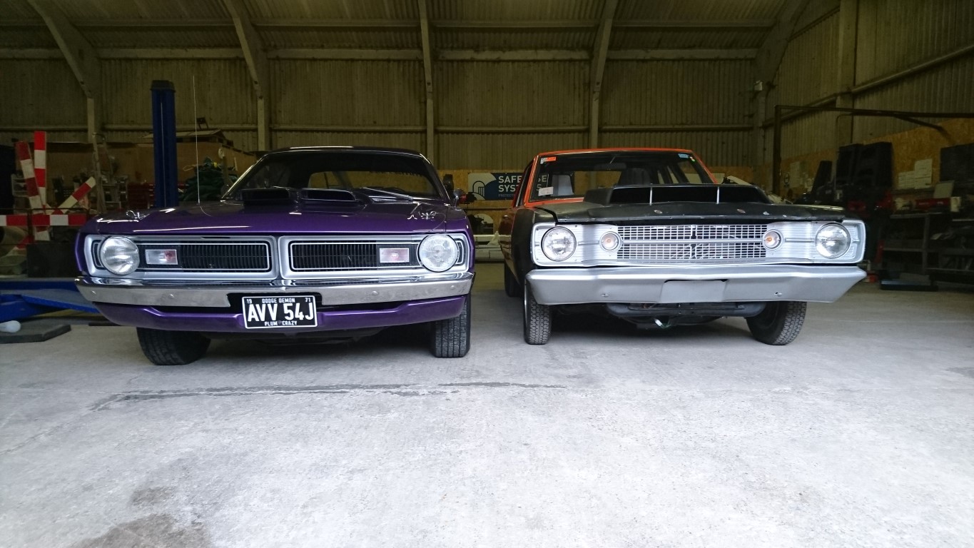

Now, play nicely you two
New Stable Mate.JPG (252.36 KiB) Viewed 9390 times

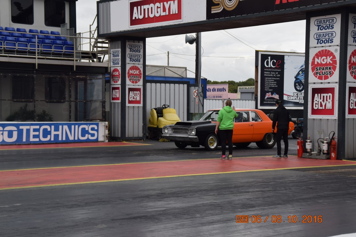

Aprehention is hidden by the camera on my first run
First Run.JPG (221.94 KiB) Viewed 9390 times

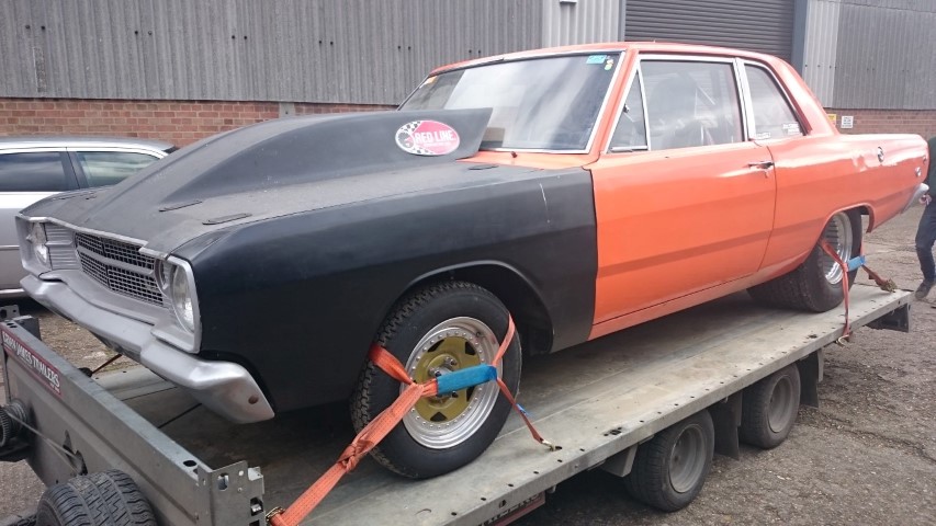

Picking the Dart up and getting ready to unload at home
A New Home (Medium) (Small).JPG (125.05 KiB) Viewed 9390 times

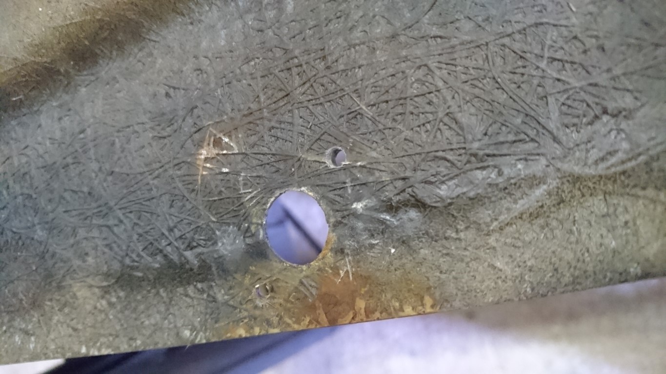

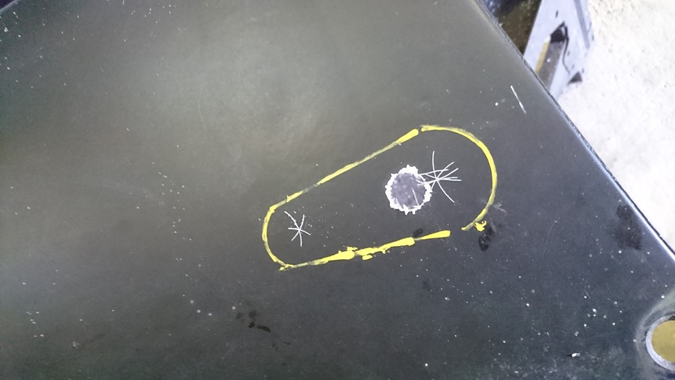

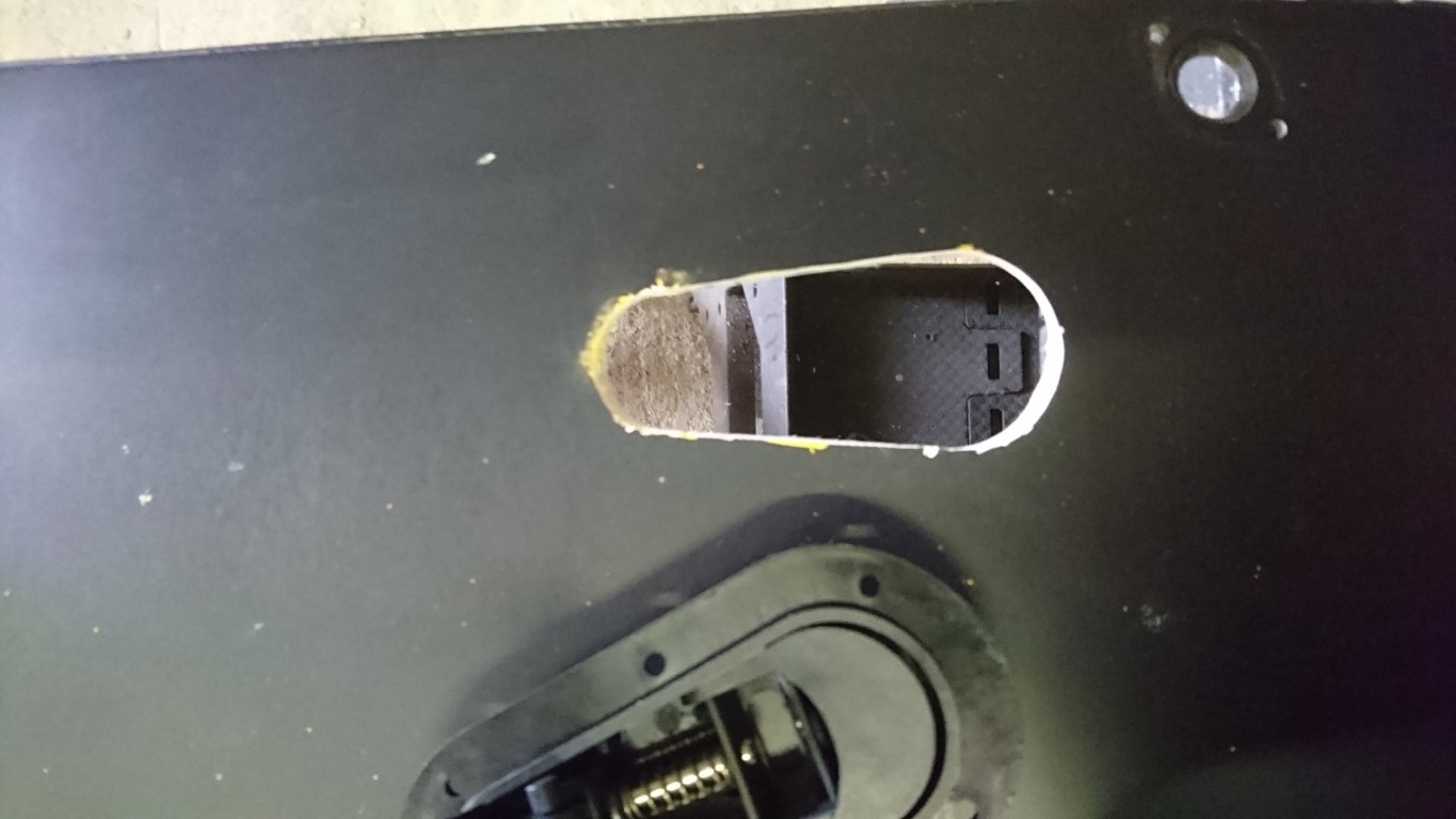

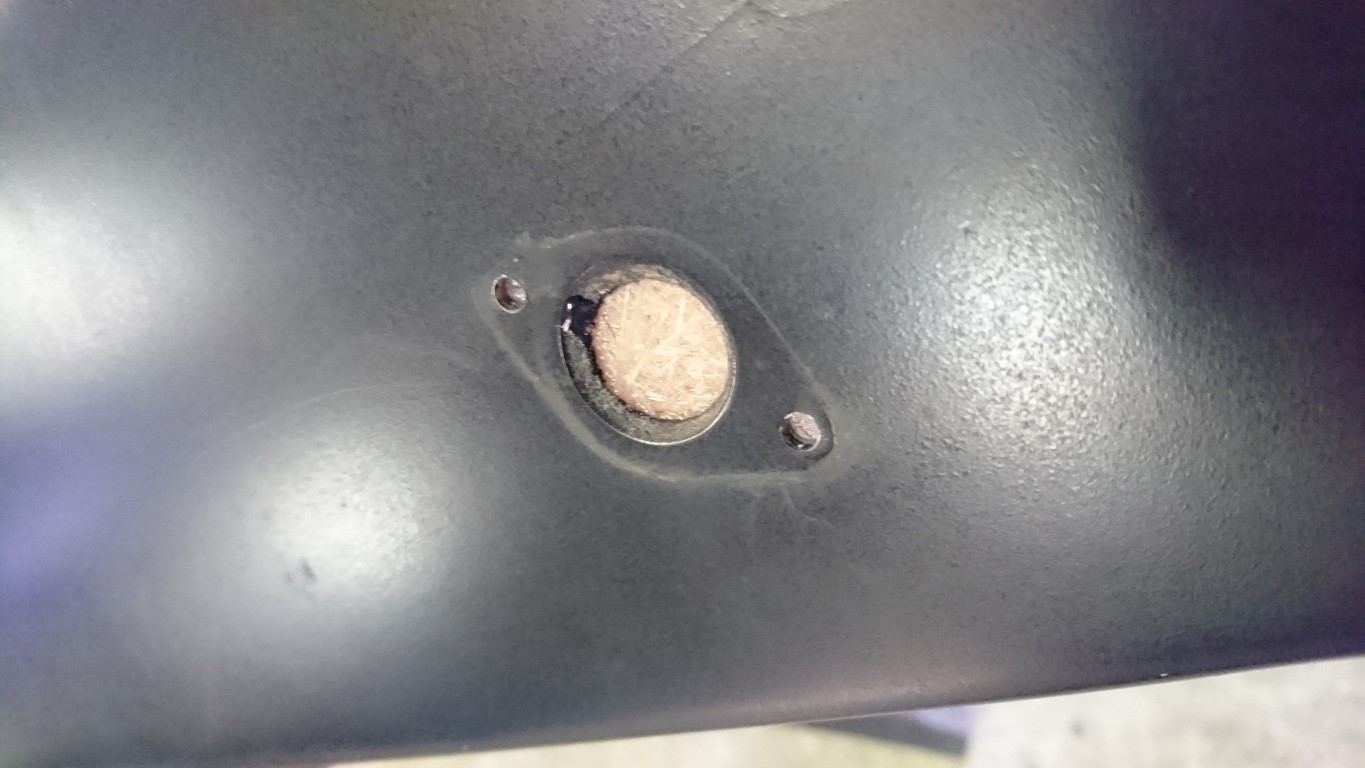

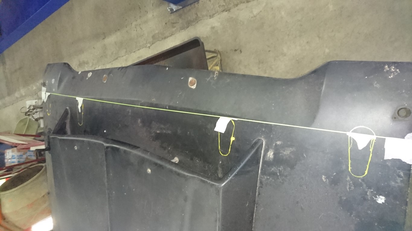

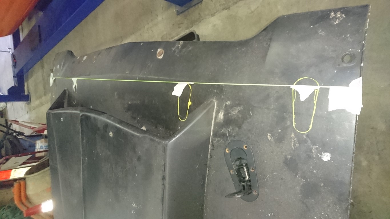

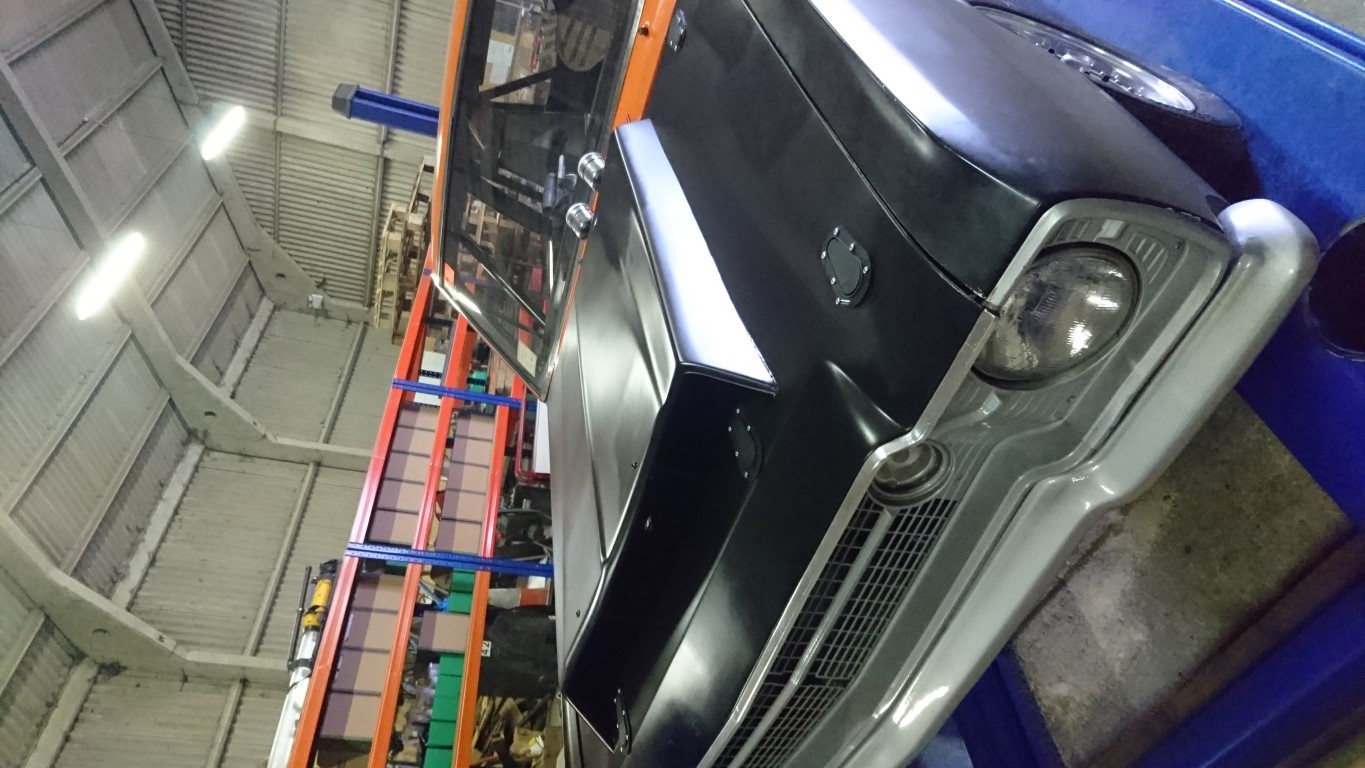

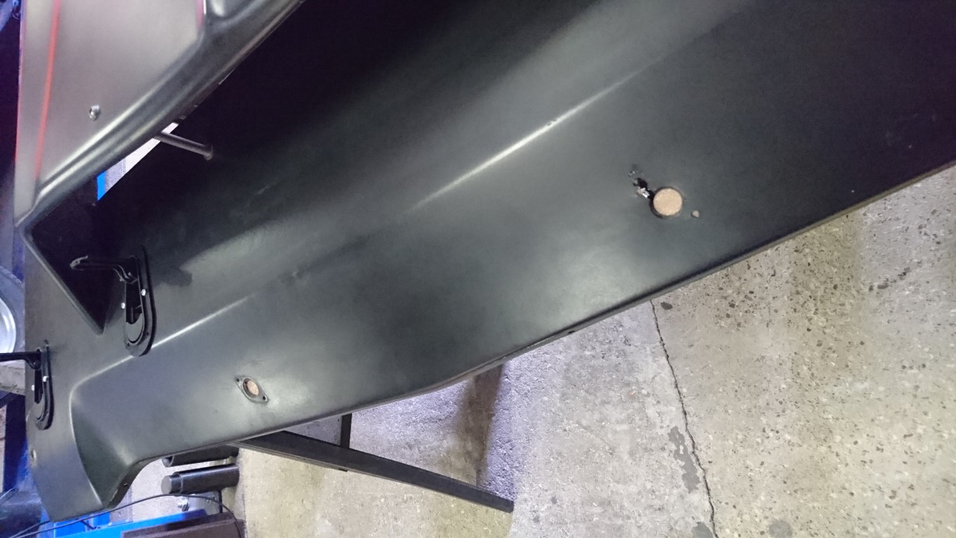

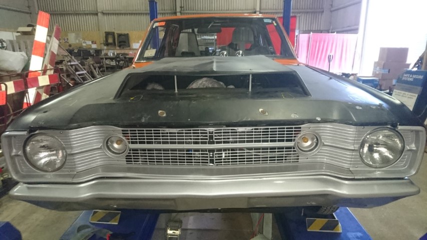

I dont quite need the induction cowl (yet) so I bought an MW Scoop from Pete and made the required mods so that it can be swapped instantly without changing hood fixings.
I bought some Aerocatch fixings and set about fitting them to the fibreglass hood. I haven't used fibre glass before, or filler and painbt for that matter but gave it a go as its a track car, not a show car ;)

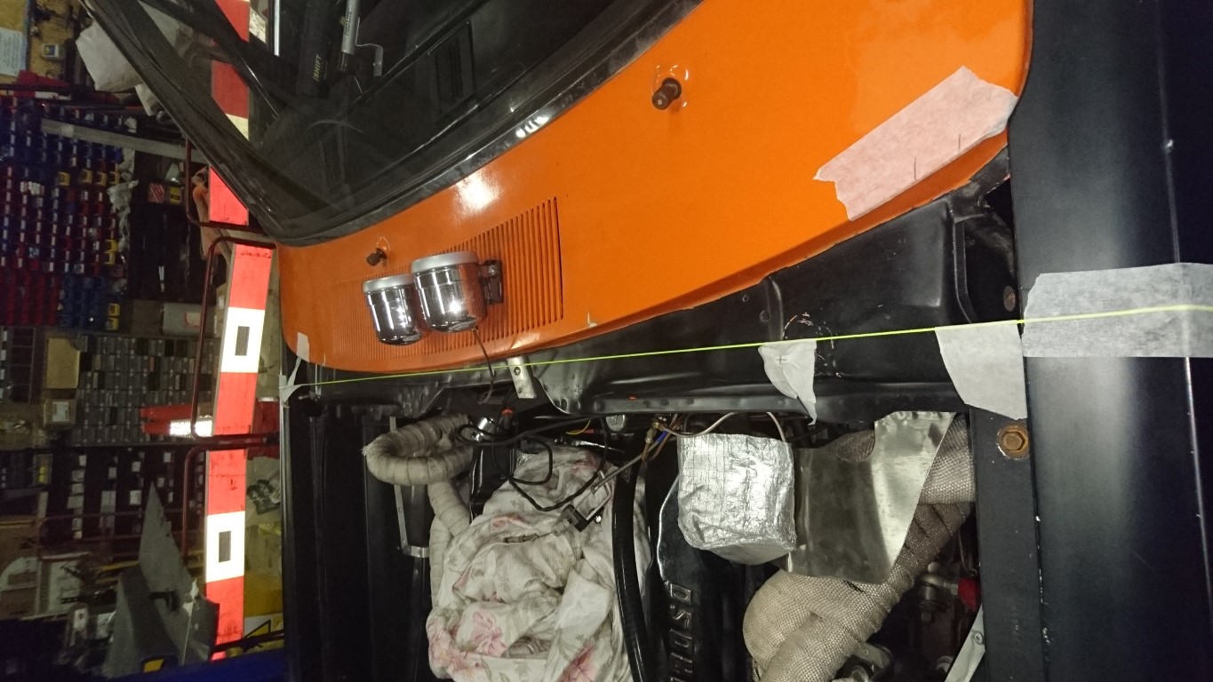

I strung lines accross the existing hood pins and tape marked them on the car. I then transfered this string with the tape marks onto the MW hood and marked the pin points.
After carefull drilling and cutting I fixed the new catches and hey presto, it only blinking fits! :)
HOOD REPAIR (4) (Medium) (Small).JPG (131.45 KiB) Viewed 9379 times
HOOD REPAIR (3) (Medium).JPG (196.05 KiB) Viewed 9379 times
HOOD REPAIR (2) (Medium).JPG (186.53 KiB) Viewed 9379 times
HOOD REPAIR (1) (Medium).JPG (254.78 KiB) Viewed 9379 times

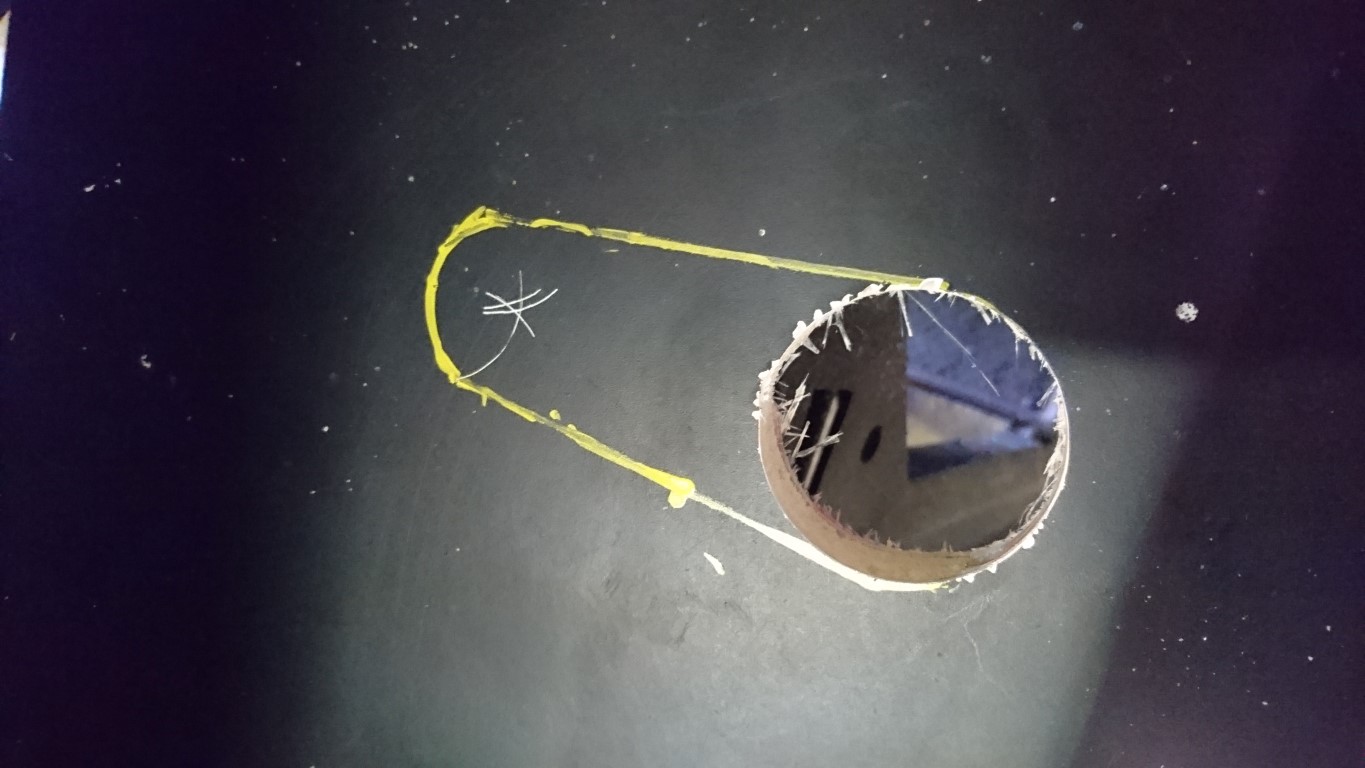

First go at fibre glassing.....
HOOD REPAIR (6) (Medium).JPG (253.3 KiB) Viewed 9371 times
HOOD REPAIR (13) (Medium).JPG (175.45 KiB) Viewed 9371 times
HOOD REPAIR (12) (Medium).JPG (221.65 KiB) Viewed 9371 times
HOOD REPAIR (10) (Medium).JPG (238.02 KiB) Viewed 9371 times
