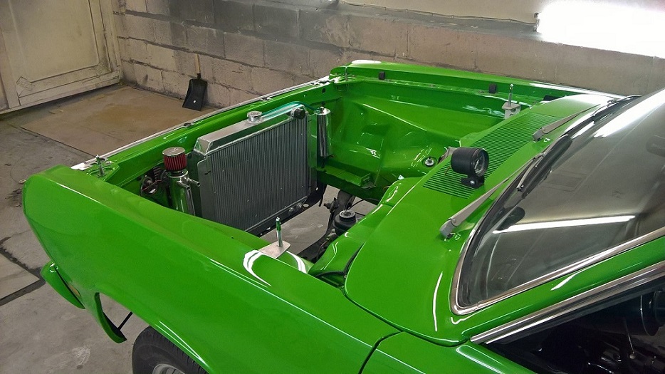

I Got an alloy rad earlier this year. Very nice build quality and it came to around £230-odd with shipping and import fees. Its a champion rad from Monster cooling. I Cant comment on keeping cool as my duster has an overheating problem unrelated to the rad which i havent yet fixed.

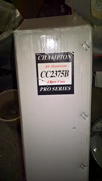

Champion 3 core A-Body rad, listed to cool 650HP job done :thumbright:

Ashley do you have a number for that Rad.
