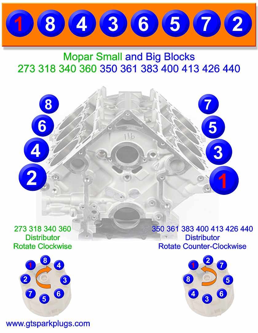

Prothed
Posts: 480
Location: Dave of Bexhill
Post by Prothed »
May be useful. Block is viewed from the front.
