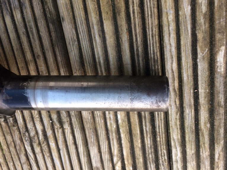

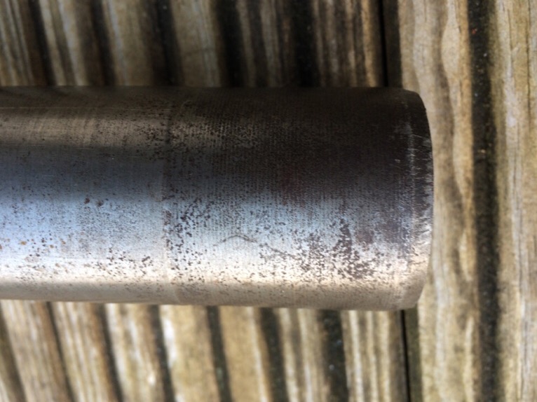

Post by MilesnMiles »
Ok chaps, what do you think? About 2" in from the end the yoke is clearly marked. This is a wear mark and can clearly be felt as a step.
Cause of my vibration issues?
Posts: 14459
I doubt it, once installed the outer part of the yoke in that area isn't in contact with anything once it has passed through the tailshaft bush.
Posts: 7309
Location: Cornwall
Ok Blue, can you clarify for me? Which part of that yoke is in the bushing area?
I thought that the yoke should be smooth with no steps in it.
Posts: 14459
The bush is about 3" long measured from where the seal is, from there on in the outer part of the yoke is out in the open so to speak so if it's not perfectly smooth at that point it makes no odds.
Posts: 7309
Location: Cornwall
Ok Blue, thanks for clearing that up. Not sure what's next if the yoke is good

MilesnMiles wrote:Ok Blue, thanks for clearing that up. Not sure what's next if the yoke is good
UJs are all goo as is pinion bearing. Looks like I'll have to put up a 'vibration' thread as it has got worse over time.

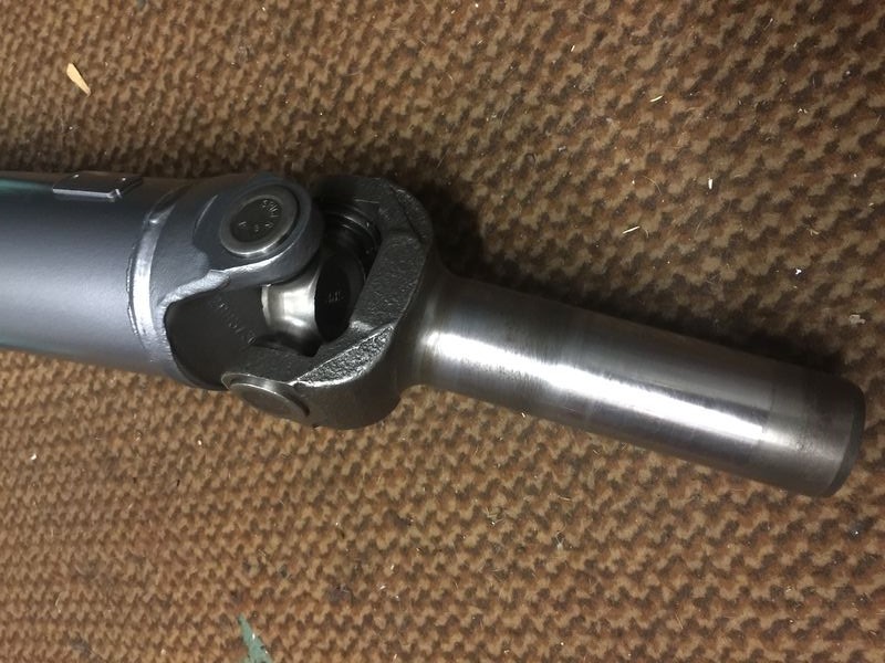

I do have a yoke question..my yoke is 9" from centre of UJ to end of yoke. Most advertised yokes are shorter.
I'm wondering if my propshaft is too short and someone has compensated by fitting a longer, truck style yoke?
Posts: 5239
Mine's off the car at the moment, I'll measure tonight, as far as I know it's all original
In your first photo, presuming the shiny section goes in the tail shaft and the black section doesn't, mine looks about the same

OK, prop was new on the car when purchased in 2012. Very minimal vibes at the time. I drove to Shakey and back in one day and didn't feel any vibes in 2013. noticed rhythmic vibes at cruise speeds on trip to Pod 2015. Got worse since despite changing UJs
Will check for weights tonight
UJs are new in last few months
Pinion bearing seems fine
Prop always returned as it came out
Yoke feels correct except for some up/down play and it does have a step in it as described above.
Interested in yoke length as mine is 9" which I cant even find for sale. I need to measure the prop tonight.
According to Denny's website, a overlong yoke as a crutch for a short prop shaft is likely to lead to vibration.
Posts: 14459
If you have about 3/4" of shaft exposed from the tail shaft then the prop is the right sort of length.
Posts: 7309
Location: Cornwall
Thanks Blue, ill offer it back up and check again. looking at the seal mark on the yoke it cant be far of that.
Posts: 14459
Yep judging by the photo it looks about right, with such a long yoke a bit more would be ok.
Posts: 5239
my yoke is 8" from centre of UJ to end of yoke
Posts: 7309
Location: Cornwall
Thanks for posting. Interesting to see that it looks as if the entire yoke is covered by the tailshaft and seal whilst mine has a section clearly outside of the tailshaft/seal as it's 9"" long.
