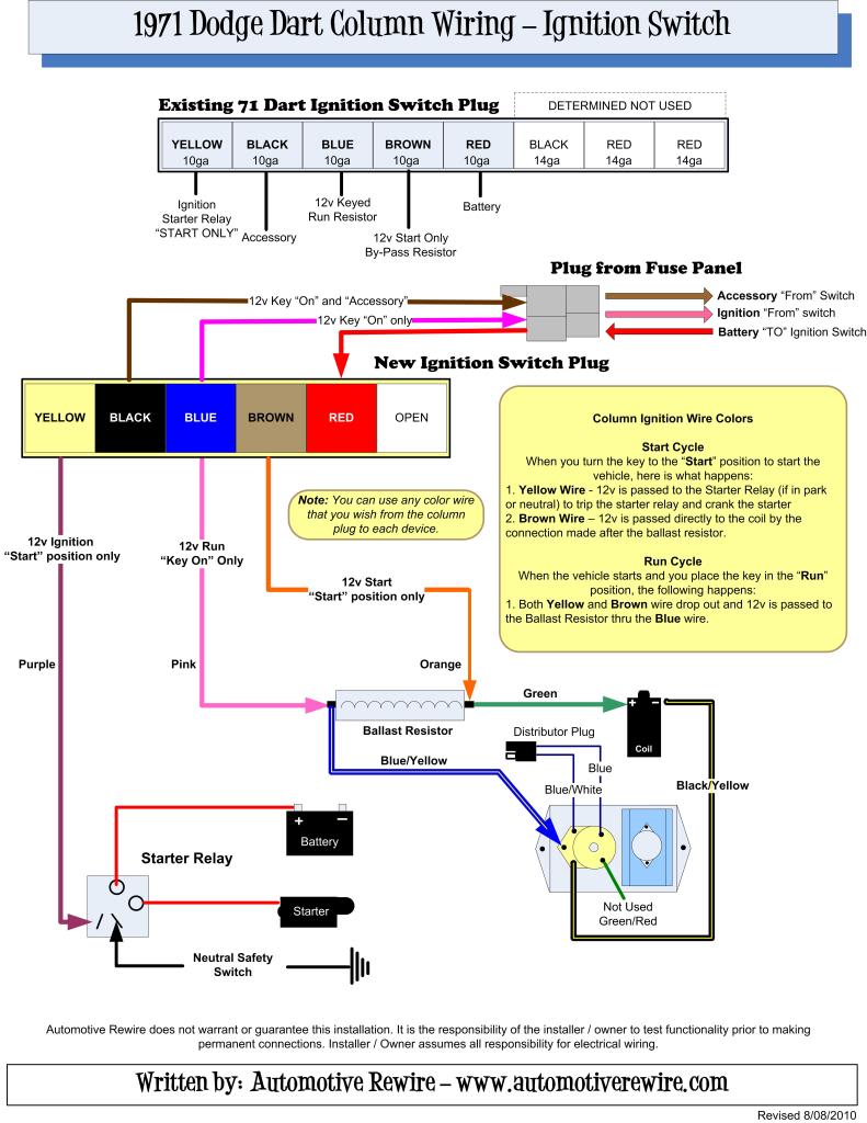

I'm enclosing a thread that shows the two switched I have as mine are identical and you can see wires are different as to where they connect on the switch.
http://www.forabodiesonly.com/mopar/thr ... rk.372468/
This diagram shows the correct wiring

Am I right in thinking that the yellow to starter should only be live for Start/Run 2 and should be coupled with the brown wire? As the car starts, the voltage to those wires should drop out
ANTON
Posts: 2046
Location: Sutton,Surrey
Post by ANTON »
yes they can be coupled together but when the key returns to ign on they must both go dead.
Brown is cranking live to coil side of ballast to give full 12v to coil but once car starts is should go dead and power to the coil must go through the ballast resistor.

Thanks Dave, I'm doing my tests in situ, but have arrived at the same conclusions. I actually got paper and crayons out and have been drawing up each different version so I know which works and which don't!
As you say, it's ensuring the 3 correct wires all go together for start.
