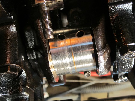

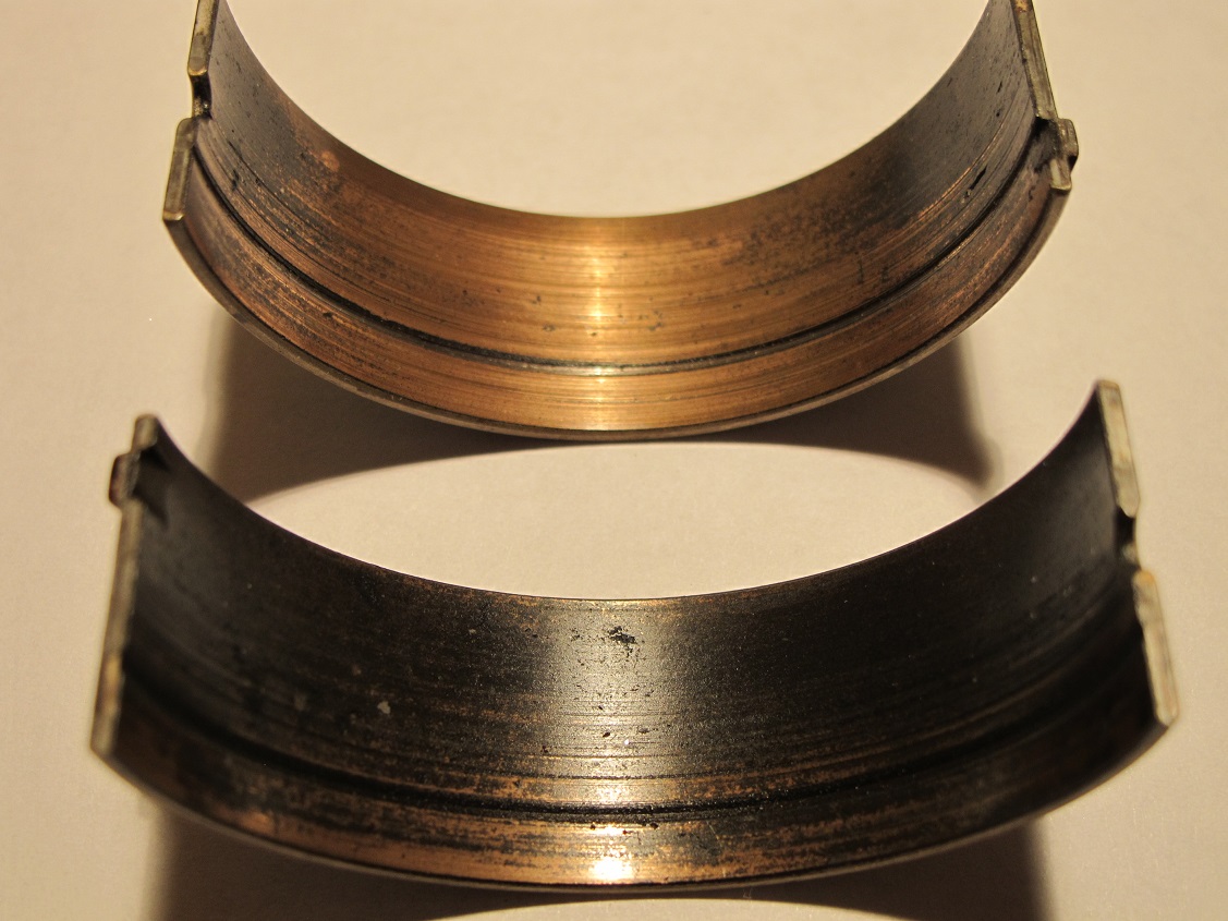

All was well, except I had a noise at around 2000rpm - traced it to the bottom end and found that one of the crank shaft bearings (big end shell) was lightly scored. (see pic). The crank is also very lightly marked.
How bad does the crank need to be before it needs a regrind? Could I get away with simply replacing the crank shaft bearings? This is not going drag racing - it's just an old camper.

The only way to be sure is to measure the crank journal with a micrometer, it looks like the bearing is back to the copper so it is well worn. You might get away with a clean up with fine emery cloth & new bearings but you should also check the big end of the rod for being out of round.
Posts: 22109
The shell looks in very poor condition - is that a groove cut in it by debris? I cannot really tell.
As Rob says, you can only ever tell by careful measurement.
You may be able to :"Get away with it" with just new main and big end shells, but my first thoughts are that it needs a full rebuild.
You might get away with it, if you run your nail across the crank and it dosn't get caught on any of the grooves I'd risk just changing the bearings.

I would have it polished takes very little off, and get it checked to see if it is still in its tolerances, as the engine is out you have nothing to lose as the crank will be coming out for main bearings to be replaced anyway, you will gain peace of mind though. Might be a good idea to change the timing chain if its a bit on the lose side too.

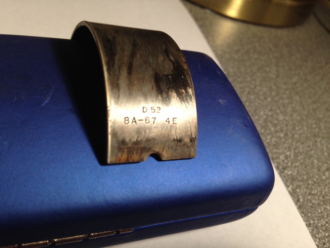

Thanks for all your advice - very much appreciated. The shell I took out (see picc) has not got a +10 or +20 on it. I am taking it for granted that the crank has not been reground? I am therefore going to order standard size shells. Is this correct?
Terry

Should be standard, the only way to know for sure is to measure.

I'd generally go for a replacing the shells, but that crank looks scored to me. I'd do it right once.

They do look a bit worn, so if it was me, i'd chuck a new set in after cleaning it a bit and see how you go. £30 for bearings is much better than engine out rebuild.

I'm with that. Clean it all up and chuck some new shells in. See what happens. Its not like they're built to tight tolerances to begin with, and like you say, its performing light duty in a camper.
I'd give the crank a go over with some emery cloth beforehand though, to see how bad the scoring is.
