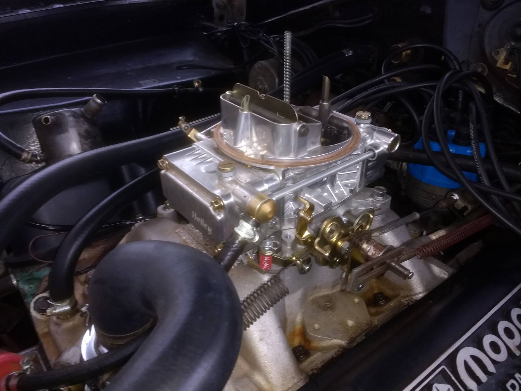

just had a quick look. The rad hose seems to be resting on it, still seems like far too much play for a little bit of pressure on the spring though.

Chris, post a pic up so we can see the throttle set up,at the carb.

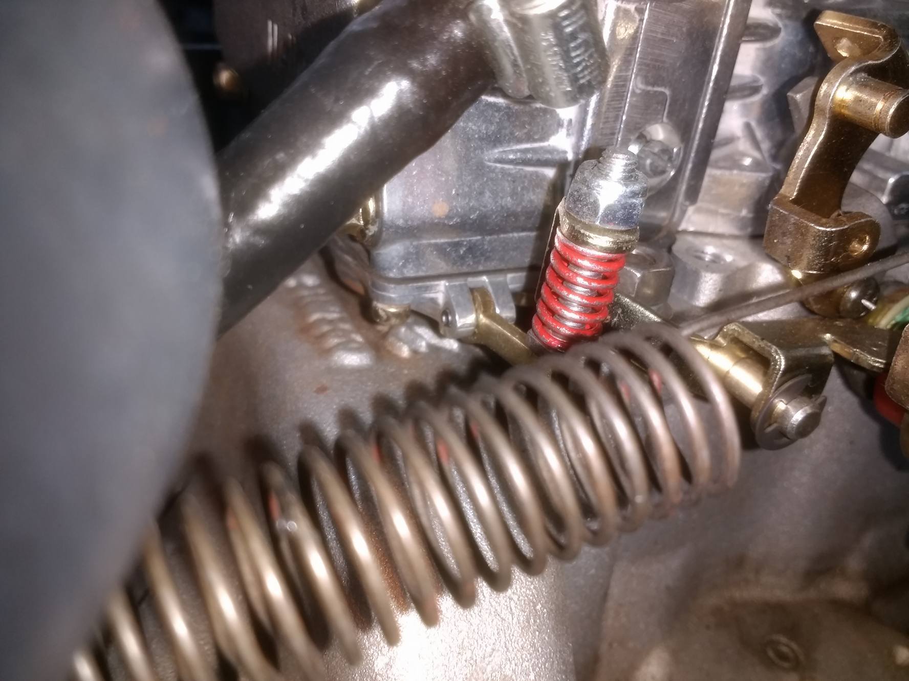

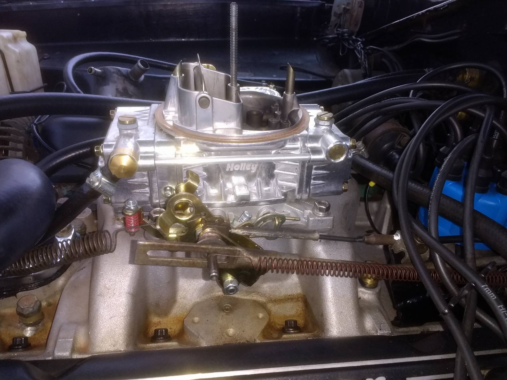

Took some pics earlier, i will get some more in a bit where you can see the hose really pressing down on the spring.
Posts: 14459
Nothing obviously awry there. Have a look to make sure the kickdown linkage isn't hitting the underside of the air filter, drop base cleaners are pron e to that.

Chris, of me I'm not sure about where the spring is located on the throttle bracket. I cant tell, but when the throttle is fully open, is that spring free to stretch without bending or catching?
I have mine on the actual arm that locates the throttle cable. Gives a straight uninterrupted run for the eternal spring.

Undo the bracket where the tip ex is and pull the outer cable back to the firewall till the play is gone and the re tighten.

The harsh gear change can be due to the kickdown adjustment which looks to be wrong.
Once you have the tickover sorted, adjust the kick down linkage by slipping the slotted end off the carb, at the pivot at the rear you'll see a hole drilled through it and the mounting bracket. use a suitable drill bit or allen key to hold all three holes inline and then screw out the slotted bit until it just slips on the carb stud at the rear of the slot. Remove drill bit and it's set. Sometimes when a non standard carb has been fitted the rod is too short to get correct adjustment so you need to weld in an extension to sort it.

I Had a little play around earlier on today, the air cleaner isnt in the way, so that wont be it. The spring that is caught on the hose still moves a fair bit, but i am not sure if that would be it.
Forgive me, i am not really familiar with all the ins and outs with carbs, so i am not sure what is what really.
Posts: 22138
There is no return spring on the gas pedal - it is all done via the Carb return spring. Get the Cable adjustment correct first - make sure the butterflies are open (but not over-extended) when the gas pedal is on the floor.
Then work backwards, spring tension, idle screw check, then kick-down levers... make sure the carb is now back on the throttle stop / idle screw.
