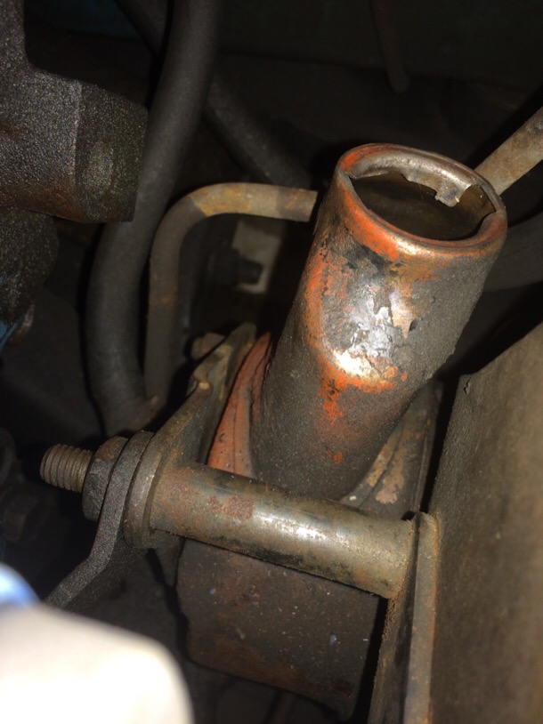

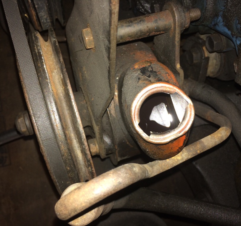

The front pulley can be easily moved by hand and the bearing is shot.
This is the pump. If anyone. An help ID I'd appreciate it.

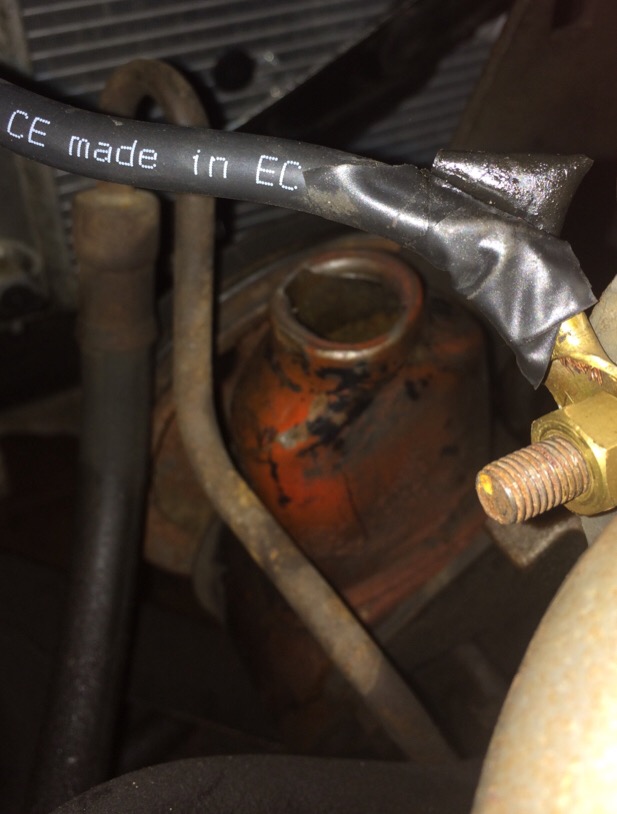

Posts: 5239
i believe that's an early Saginaw
same on mine
http://www.bigblockdart.com/techpages/pspumps.shtml
Posts: 7309
Location: Cornwall
Post by MilesnMiles »
Cheers, I thought so too. Wonder what it came off as my car should have the later version given its a '72 build?
