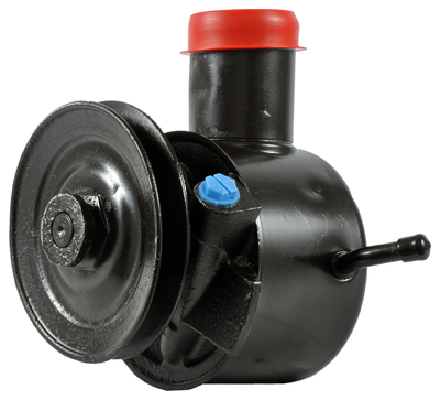

Hey People, got myself a leaky power steering pump #7232110 67-68 year specific and nobody seems to stock them has anybody used a different one to do the same job.
Cheers Bryan
Posts: 7309
Location: Cornwall
Post by MilesnMiles »
Just waiting for mine to arrive from Rockauto. They do a range. Mine was £60 to the door inc taxes.
Yes I have used the Federal, as well as the Saginaw type, some bracket swapping and it will work fine with either .
