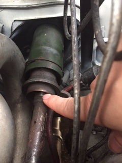

Recently I've upgraded all my front suspension which has included getting rid of the K frame and steering box and converting to a rack & pinion steering rack.
From what I can tell the steering box held the steering shaft at a certain angle when heading up into the column and through the bulk head.
Now that's been removed and the new kit is installed I have nothing to hold the shaft in place within the column. The rack and pinion was from flaming river and was actually for 79-93 Mustang so the rigid plastic grommet they supplied was unfortunately the wrong size.
I've contacted them and they don't supply anything to fit my original column and it would involve me buying a complete new column off them to make it work.
From what I can see I just need a rigid plastic grommet to slide over the shaft and up inside the end of the column to hold it all in place, I can then for safety drill through the column into the grommet and secure it with a screw.
anyone know where I can get one, or anyone who makes plastic components to size.
I've attached a picture to help explain what I mean.
Ross

This might be an option
http://www.forabodiesonly.com/mopar/thr ... er.228103/
There is a nylon spacer thingy which is what I think you're looking for. There is what the yanks call an 'aged' version which is in two halfs and can be fitted to the column in situ

thanks for the links, the build thread is really useful and it's exactly what I'm looking for but unfortunately I have a column shift so if I cut the column back to be able to insert that size bearing I will cause problems with the gear selector.
I need that type of bearing but with smaller dimensions, I'm just searching websites now to try and find a company that would make them as they appear to be really strange sizes!

bush
give me a call- my mates dad in park street would be able to lathe something up for you.

"Anton" on here made some adapters up that have "Proper" bearings in them that go into the Outer of the Steering column.
One thing I found was that often the Steering inner shafts are not straight.
You don't notice this with the Mickey Mouse factory bearings, but the minute you have positive location top and bottom, it will bind the steering up. Worth checking to see if the column shaft is eccentric - I learned the hard way!
