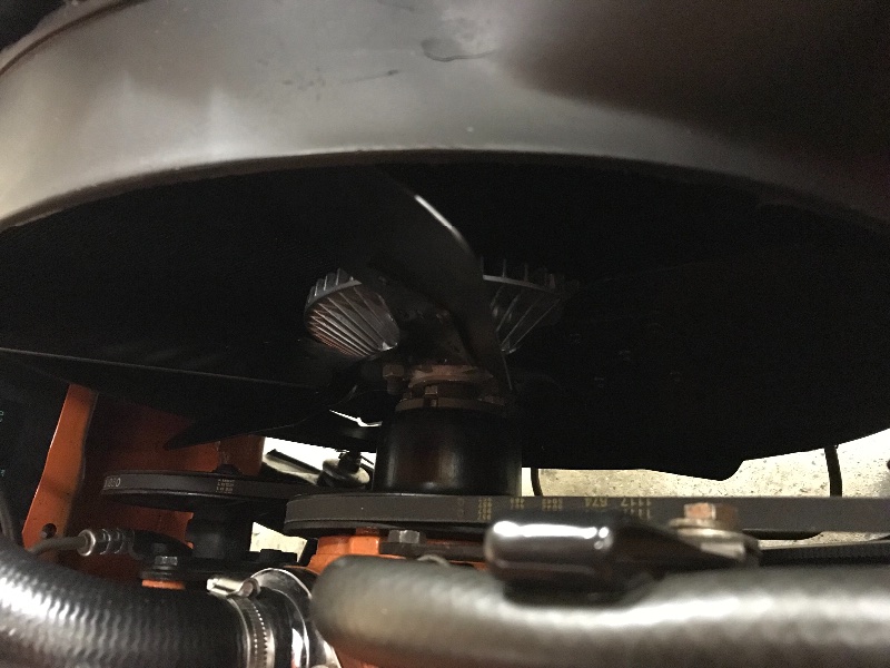

Well after waiting months and spending $$$$ for my fan clutch, fan, studs, nuts, blah to replace my plastic fan the last part arrive yesterday.
Into the garage and after 20mins spannering out comes the offending fan in goes the new set up, or not. It won't clear the radiator FFS.
All parts ordered correct for year and model, newly rebuild radiator seems off the core support by an inch, rad is for a C body, any ideas?
Hemimad
Posts: 310
Location: Chester
Re: What's gone wrong here?
Post by Hemimad »
Update, it's the clutch. The wrong code is stated by the supplier, looks like I need to order another.

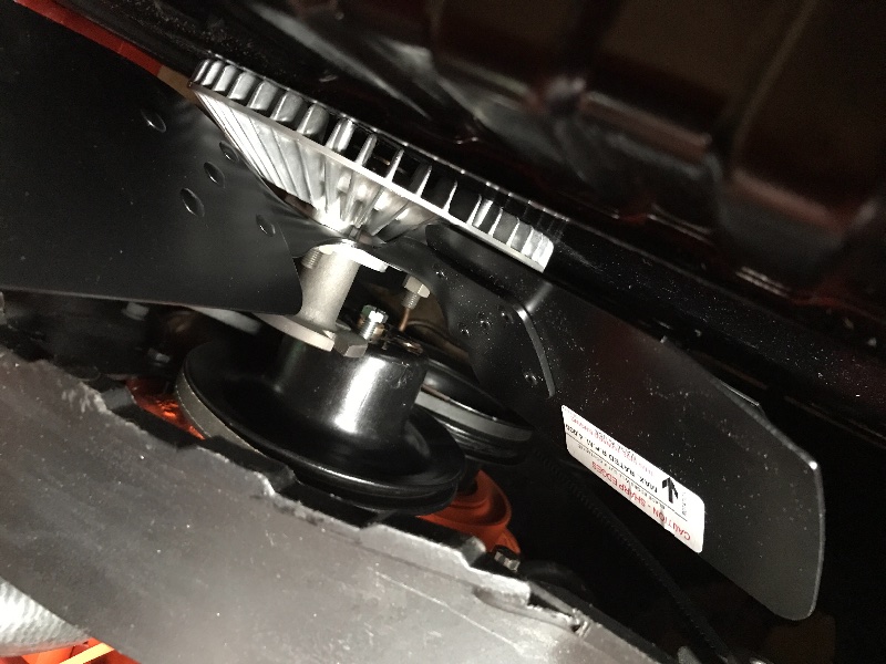

Finally, after a load of research, managed to get a new Hayden HD unit aimed at B Body Mopars with a short shaft, perfect fit. Rockauto stocked it and it only cost me £60 delivered to the door and took less than 7 days to arrive, result!!!
Posts: 1398
Hi Dave, that looks like a right result, well done!
Rob & I had the same problem with our Satellite.
How much shorter is the new clutch shaft? Was it just the shaft you changed, or did it come with a new clutch for £60?
Do you know what part number you ordered?

Hi Stuart,
Hayden Part 2947, loads of clearance easy inch shorter shaft.
