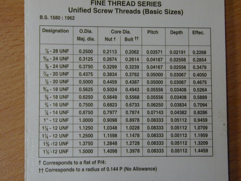

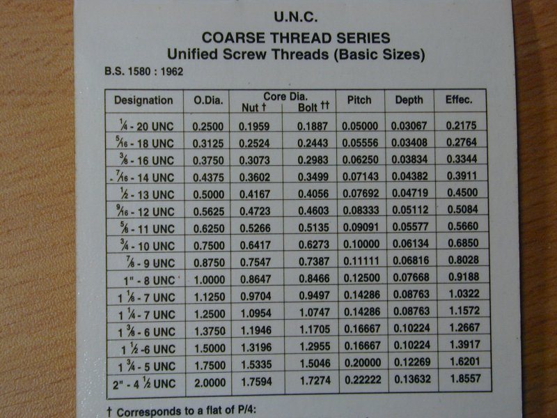

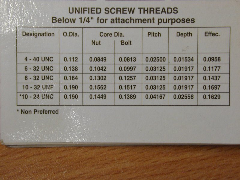

Posts: 3539
Re: Thread type help!
These might help to identify;
