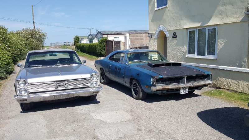

I can help you with what will fit / measurements as got a 66 Fury and a 69 Charger here to compare against. Im buggered at the moment as Ive fractured my foot.
- 20170504_112001.jpg (97.32 KiB) Viewed 5469 times

i hope your back to full fitness soon,Ill be heading down to cornwall in approx two weeks so ill have both cars here in the workshop
the main reason for the purchase was the 440 engine,gearbox and axle if the brake disc conversion fits even better if not it will be put on the fury and ill source a kit for the charger thanks for your interest
