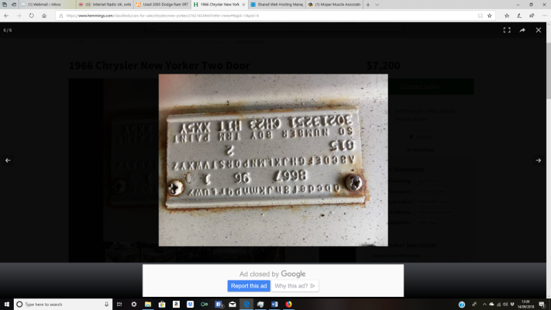

There's a 66 Chrysler New Yorker in Ohio that I am more than interested in and I can't seem to get the VIN tag decoding correct. So I thought I'd look to you all for help please.
The attached picture is what the seller alleges is the vin tag and as I'm not yet a MOPAR owner I'm struggling to define the original build. Any direction or help please is very much appreciated.
Thanks everybody.
Thanks everybody.
- 2018-09-14 (2).png (243.6 KiB) Viewed 4174 times
Re: chrysler new yorker vin help please for MOPAR novice.
Mounted "upside down"
Not helpful I agree, but was funnyPete wrote: Fri Sep 14, 18 9:33 pm Not very helpful to a "newbie". Please play nicely and help the man, thanks.
This is a possible start point
http://www.stockmopar.com/mopar-fender-tag-decoder.php?
this is quite good
http://www.dodgecharger.org/cgi/f66.cgi
and this is the result, colour looks correct.
DodgeCharger.org -- 1966 Fender Tag Decoder
This program is still under development.
Please send any corrections and/or comments you may have.
Top job, thanks, Matt!

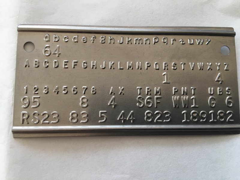

"Matt" ……what do you make of this
- IMG_2120.JPG (74.69 KiB) Viewed 4111 times
