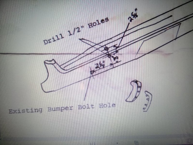

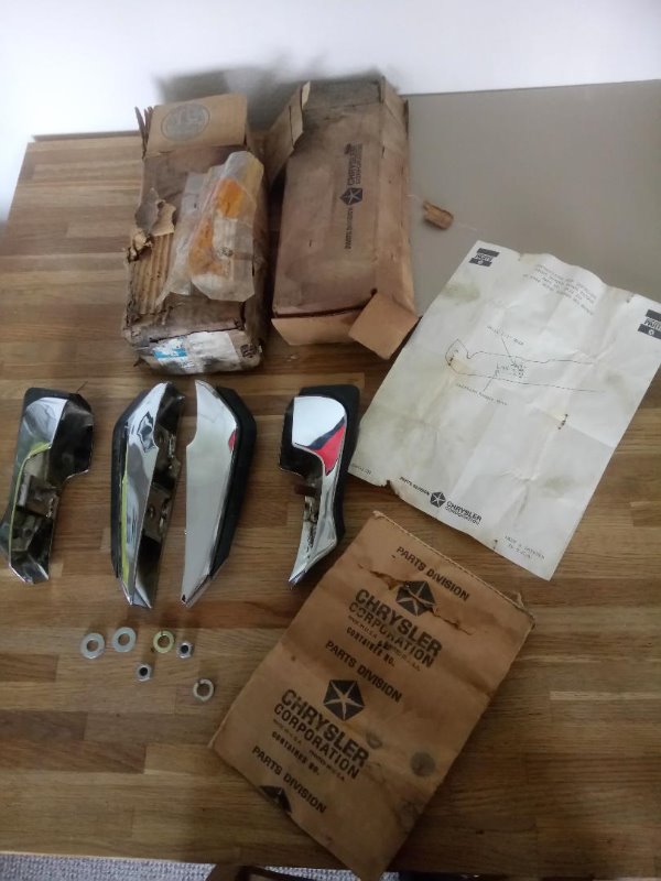

I recently found a lovely set of NOS bumper guards for my 68 Dodge Polara sedan in Carson City, Nevada. Believe it or not, the shipping and tax etc was more than they cost to buy ($80....bargain!!). Inside the pack that came with them is a drilling guide for mounting the front ones. Unfortunately, the rear guide sheet is missing. Does anyone have access to the measurements or better still, a copy of the relevant rear sheet that I can use for drilling the rear bumper holes please? I obviously only get one shot at it so wont be doing it until I am 100% sure I have it right!

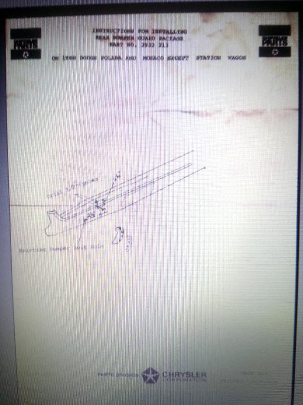

Thanks Dave...tons to trawl through there! Cheers. I have emailed several sellers on Ebay US to ask if they would mind photographing the sheet in the hardware packaging for me. One says he will look today but not holding my breath! My Polara has a twin!!!!! :thumbright: :thumbright: :thumbright:

SORTED...... slightly before CAD was invented....
I still haven't worked up the courage to drill my bumpers. A job for 2019 I think. Thanks for help gang

nice
get that scanned and up on C bodydrydock or mymopar
or indeed here.......we can be the source of mopar bumper guard happiness going forward
