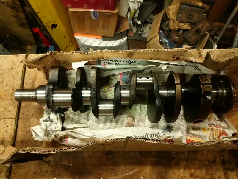

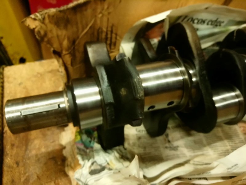

Popped in to see the machinist on Tuesday, turns out there was a little bit of miscommunication between us.
The crankshaft was still in his grinders chuck, so he ran it up and yes the Flex plate end was running approx 5thou. Our misunderstanding was Martin thought I only wanted it taken down 10 under, he wasn't sure if that was going true it up and wanted to talk to me first before carrying on.
Told him to take it down to whatever it needs 20/30thou etc, turns out it cleaned up and ran true at 10thou anyway so alls good. Picked up the crank on the way home today so now I can get around to cleaning up, repainting the block and heads, sort out a Rockauto order and get on with the rebuild.
Not sure how far to go with this rebuild as yet, tempted to go 4bbl inlet & carb and possibly a cam
Obligatory shiny crank journal photos
- DSC_0957.JPG (109.29 KiB) Viewed 1216 times
- DSC_0958.JPG (64.51 KiB) Viewed 1216 times
